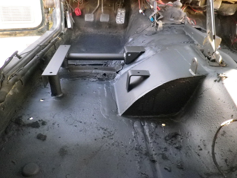

OK, let's see if I can post some pictures of the installation.

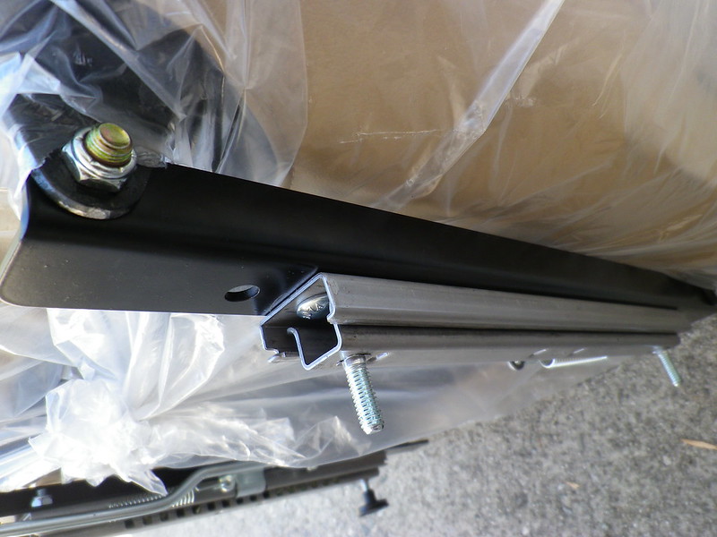

PRP Slide assembly, not included with Daily Driver seats

Adjustability is why I bought the PRP brackets.

Test fitting custom mount to the PRP slides.
IMGP5492 by david_bricker, on Flickr
Passenger side welded in
IMGP5496 by david_bricker, on Flickr
Driver side welded in and primered
IMGP5499 by david_bricker, on Flickr

One of the other things I did when mounting the seats is to move the passenger seat mount further forward, by about 3", then the original location. Being a 2 door, access into the rear seats is always an issue. With the old seats (not stock), I could barely get a medium ice chest in the back.
Now, with the PRP seats, I can slide the passenger seat forward, and tilt it such that it contacts the dash, enabling a much easier access in to the back seat. Of course, now's that pesky roll cage horizontal bar to have to do the Mambo under, but hey, I do't have to sit in the back seat. About the only bennie of being the owner.
Even with the seat mount moved forward, there is enough travel in the seat slide to have plenty of legroom for the passenger.
