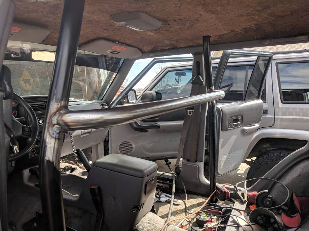

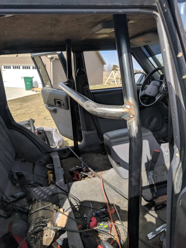

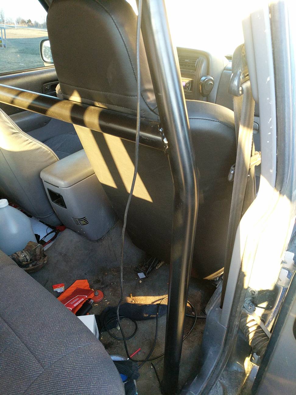

I put one in on untouched factory brackets. And it was brutal.. My head was touching the headliner pretty good and the seats were leaned back too far for me. Which resulted in the back of the seat was hitting the harness bar, and had to move the seat all the way forward to fit.. And I'm not a little guy so that was going to work.. I decided that i was going to cut the front of the factory brackets and lower the front of the seat which would give me more room all the way around. And then i decided to cut out the straight harness bar that came with the cage kit and have a bent harness bar made to gain more room behind the seats for harnesses and more leg room. Ultimately i should've had the seats before i did the cage. My b pillars are too far in and barely hit the outside of the seats so i believe after winterfest, the b pillars are going to get chopped and moved. But the way I have then setup now, will work good. Here's a few pics of when i first put one in. And then a couple pics of the new harness bar installed yesterday

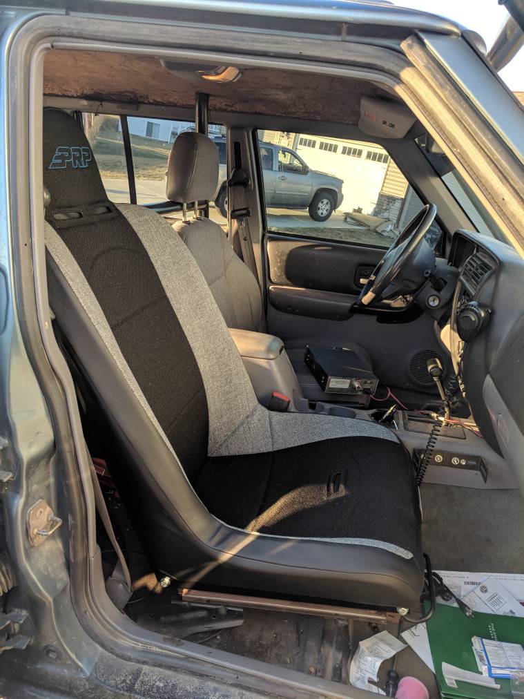

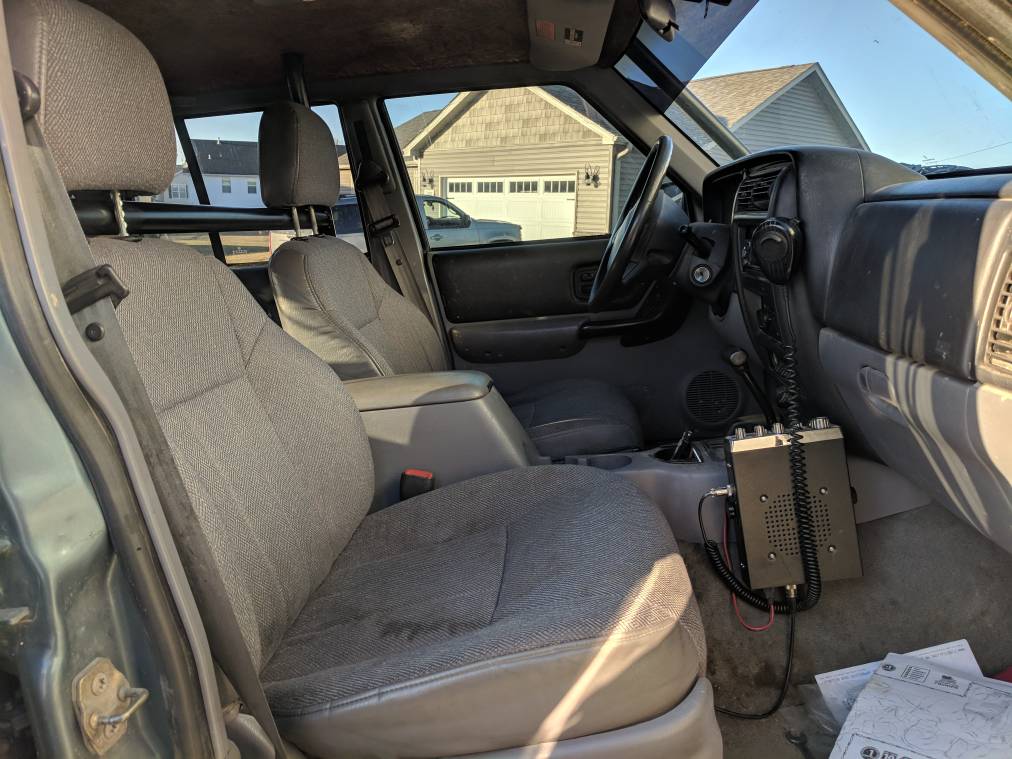

Got around to installing them. Had to make new brackets. Super happy with them. Not as plush as the factory seats but way better support. They are very comfortable, warm in the cold weather, about the same size (rear passengers wont be smashed) and the factory seat belt seems to work well. They are about 1" shorter which is nice. So far they are a bit difficult to get in and out of, I am 165lbs at 5' 11". I am sure I will get used to it. The upper part is wider so not much room between the seats. Build quality is extremely nice compared to the price (I think they could charge more).

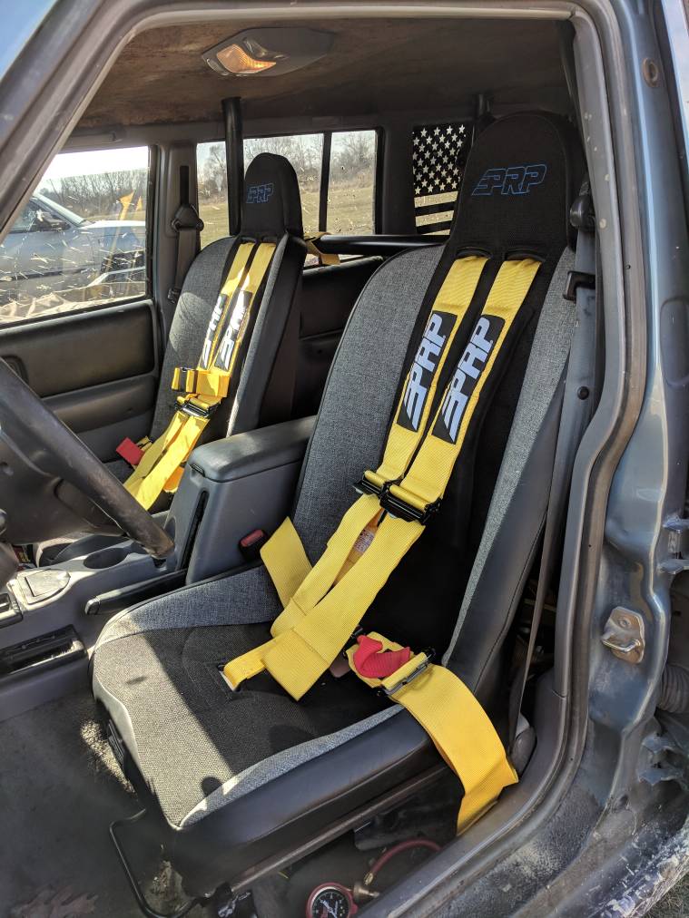

I also got around to installing mine. IMO they sat an inch higher than stock seats. And using PRP brackets on stock mounts, the seats sat leaned back too far for me. So i chopped the front of the brackets and lowered them about an inch and a half. They are much more comfortable than stock. But are a pain in the ass to get in and out of. I figured thats just because I'm not a little guy.. 6'0" 280lbs

The seat height is about the same (headrest height vs stock headrest height). The whole seat is 1" lower. I built the brackets that way on purpose though as I wanted to be a bit lower, that's the one thing I hate about the XJ, the seating geometry is was to high. So yes, I gained 1" additional space between my head and the roof.

The brackets were super easy to make. Use my pick as a guide. They were 1/8" by 1" angle iron.
