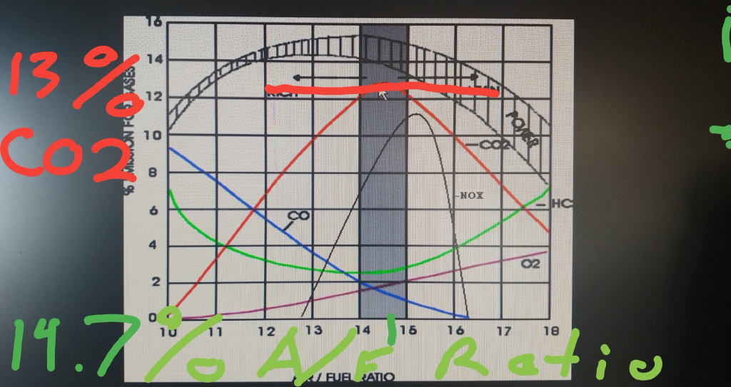

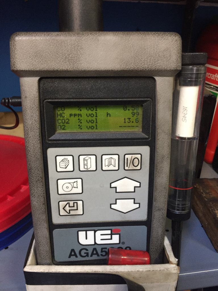

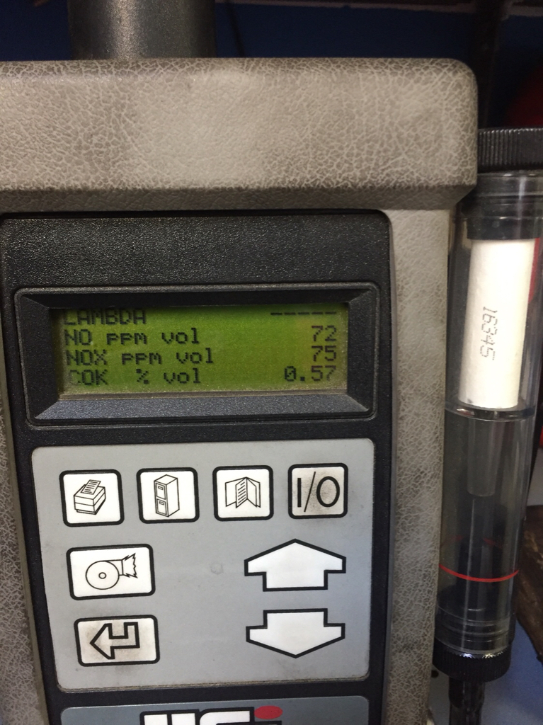

Finally got it running good. Dizzy index was off and had no way to dial it in without cutting tabs off. Tried new tune and stock tune. I think the new tune needs a new data log since i have new o2 sensors and a new wideband . Need to datalog and send flyinryan a new data log. Thing handles so much better its not even funny. The leaf sliders made it incredibly stable. I can now handle turns at speed much better and its just so much more stable.
