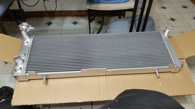

Someone found an all-aluminum, USA-made one over on Amazon (Brand is OPL - "Our Parts are Legendary"). He made a thread over in OEM Tech about it. Might have to get him to chime in here with pics and impressions - never a bad thing to have more options.

Got the Auto Dynasty/DNA Motoring in and it's cooling nicely, ran it by the local Advance Auto to have them pull the CEL Code (it has a bad miss, specific thread is pending) and one of the kids that works there knew of the work being done and asked about it so I tossed him the key and let him go take a look while myself and the other guy were looking into plugs and wire prices then went to go see what the kid thought once there was somebody in line. I walk out the door and the first words out of his mouth are "You guys stole that radiator!" He was surprised how nice what he could see of it looked and told him how it all but fell into the front end when we put it in place, despite what the reviews said.

The Auto Dynasty/DNA Motoring 3 row aluminum radiator (found on Amazon)

For what little it's been driven so far, that Auto Dynasty/DNA Motoring one seems to work nicely, I let the truck idle for around half an hour after getting back to the office after running an errand on my lunch hour, and the temps stayed right in line with what they should be, even if the belt was slipping on occasion!
