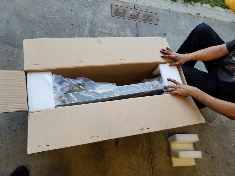

Well packaged from Texas, 4 days from order date:

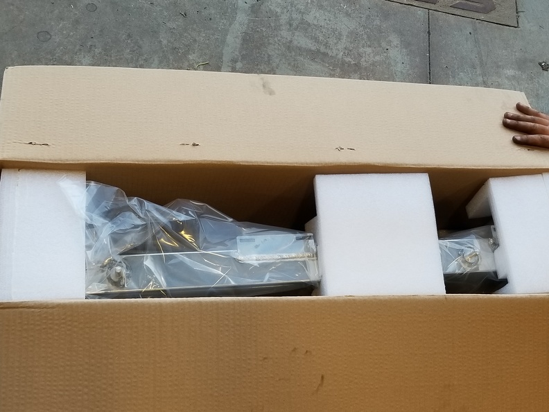

Good foam packing:

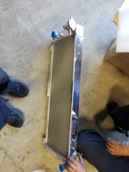

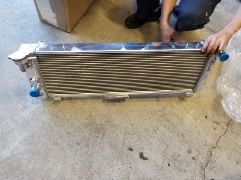

Unpacked and everything looks great. All painted black. Quality looks great.

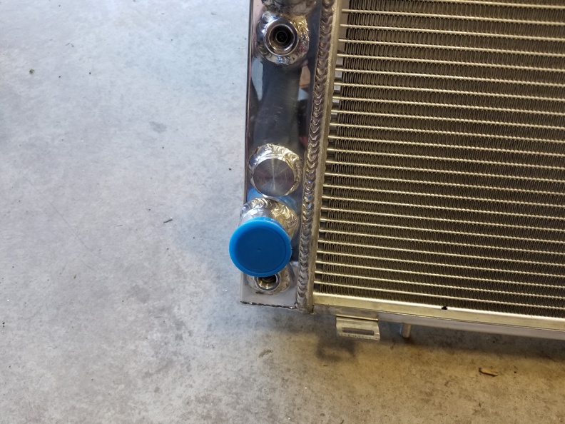

Transmission fittings:
w8YPjrhO-yOELQr9LHuzTjZvNTvAg_ZgM83QCLmhSCJQqHK6O_bpY_4Dk8rN-jGOrovoAyg9yc2CWbRxoFOMxHrXHnWrgOHwMe3qbL7DwcVuGO76IQk_4Iuy6vJQ1zMnpY86KwCPcvhHbHgcYRo35DhqugTPy0L3HLvGvqB6X7Luw7-zgEsnEGHZWFZrDpCAtJlmSUH5SGsTAmPgMLqRH7AXNSzKGnk0qdB8K148632GefJIboIpx3RzPvDf8vqw6CA9MIdtPgMKzOu-zOZl74pQcxhLyhXv6xf4f9y7DBihgZ2sFNj8Vh2qm0sy-wyt5arbvVcPkqs9RMzP0hq4kcYjClhl6CGZylILuacmSPDM-0mmiW6me2ZgDe0NmUJlFFsKiATMLeSwP0oQOzbM-OKmU1dxQxjlljcjPsVvmaEKAk6VgEQ4aUxB_Rgvcmx83G1DeYXpclkw7qUQ_OSC22ulTAdcDofTIht5oHxe4qUfC2qrfz-cJe-s1iRO89LQVDAZSG1RubfowjSnRefFYgr6xYZB4ombjVWvfaFLZRgN5SeScXwTwhg9_cIqHwuocVHcYur-kMFM1pBJ9GmVK_f4NxkKPkliuRrdQMu1FIdIwBWtcBtm2FL73zUsGwF4oONeqhfRT0OJWEJ_YoAYp-LpI_9sLHekLS3SWVVjwbpv6aCsjH1hVQBVFc77t_V8Cbcn-bjp-4MQvWhBkRsbsD-lOQ=w1713-h1284-no
came with fittings for the transmission cooler. The upper fitting does have a petty small hole given the stock fittings are 3/8" ID hose. So I drilled it out to 3/8" before installing.

Core depth is right around 1.75", 2 cores. I'm pretty happy with that setup.

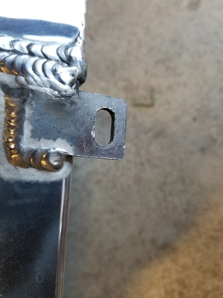

That's about it. The drain plug is plastic but I'm okay with that. No weirdness anywhere on any section of the radiator that I could find. All the tabs are straight and fit just like stock, all the same nuts, no sharp edges, etc. It seems to be a dead ringer for the old Modine HD radiator that was sold 12 some years ago. Price is a bit on the high side but Copper/Brass have gone up over the years.

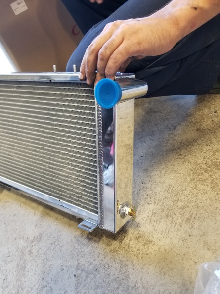

Finally unboxed Dallas's Champion radiator.
Very similar specs to the Auto Dynasty one but better build quality and polished.
The machining is a lot cleaner, so are the welds.
Proper drain valve.
It came with all the trans fittings and new o-rings for the quick disconnect, but I somehow didn't save the photo.
