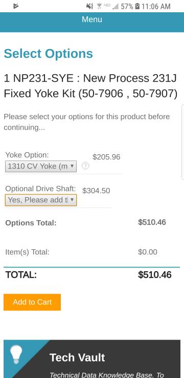

I found this kit for the sye and drive shaft. I added an image below because I'm a little worried this wont go together. The only info they needed was about the u joint 1310 and my t case which is a part time 4wd.
That's all they needed in order to send me a sye and Tom woods drive shaft.
No lift height questions or rear axle questions. It's a Chrysler rear axle.
This still going to fit? Will order tonight

Looked at it. Says between 4 and 6" and I'm doing a 3.5
The drive shaft in the sye kit must be a generalized size for any lift. I'm sure it will fit I just wanted to see if anyone knew. And i called tech support the verify it comes with all needed u joints
All driveshafts come with the u-joints installed, other it would be a "build your own driveshaft kit"
