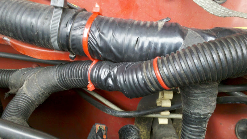

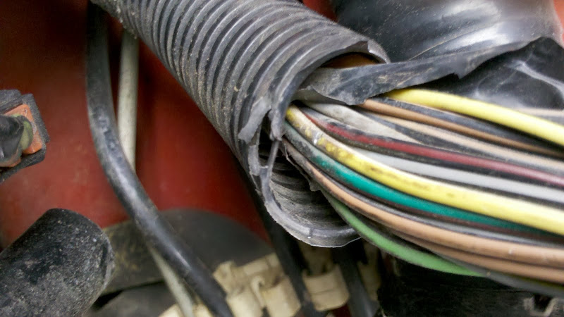

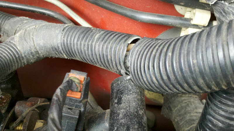

Today, I fixed a problem with a CEL I was getting for #3 Cylinder Misfire.
Wiring Loom was rubbing on the fuel rail, grounding an injector wire.
Only happened when I put the Jeep in reverse - quite odd!
I can't believe this occurred with the exact same wire as mentioned in that post I dug up.
Read more about it here:
http://www.naxja.org/forum/showthread.php?p=245625670#post245625670
The fuel rail rubbed through the brittle conduit, and eventually my #3 injector wiring.
Yellow/White wire had a very small slice, exposing the bare wire.
Secured!
