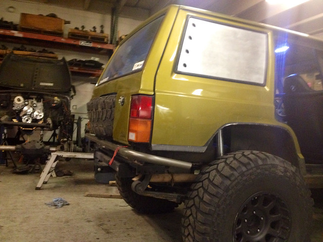

Bumper progress. I'll have all the pieces soon and be able to weld it up next week.
Those look sweet. Are these shackle D rings? If so they look really thin on the leading edge near the hole.
Well...... how else was he supposed to fit the engraved name??? Form over function man, get with it!
Hey, if you leave a shackle screwed into the hole...... does that make it a Prince Albert?
:D
We've literally suspended a jeep between a tree and the vehicle being winched with one of these shackle mounts. I'm not worried about it failing.
