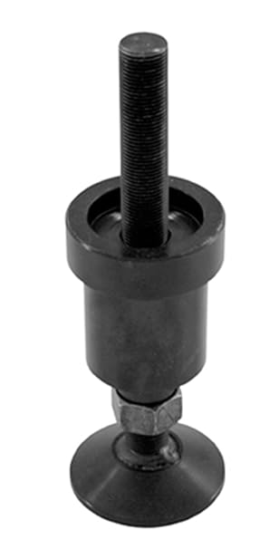

I've got the special tool/press for those seals if that happens.

I may try it on the 14 ...The front axle needs no special tools to replace the inner seal it does require you to rip apart most of the axle to remove the carrier to access the $7 dollar seal . I blew up the stock 79 passenger side neckdown shaft splintering it into 6 pieces Detroit was fine the seal got chewed up and it took me 5 hours with a magnet and the axle tilted to free the 12 inch section sitting in the Detroit ...lol...that last few inches in the detroit is the only 1.5 beef on those early 79 60's ...to be fair to the shaft my brother did slam into a ledge at 15 mph as tall as the tire compmetely stopping the Jeep and bouncing it backwards a good many feet...lol...I was outside watching him do this and the impact folded the tire in almost to the rim before the jeep rebounded back , soit does take a bit to kill even the most wimpy 60 shafts .
The tool I was referring to is this:
It allows you to easily press the seals in straight.

Thanks for the tips ...lol...I did my 60 seals caveman style...hence the reason I bought a spare incase i bent it .
