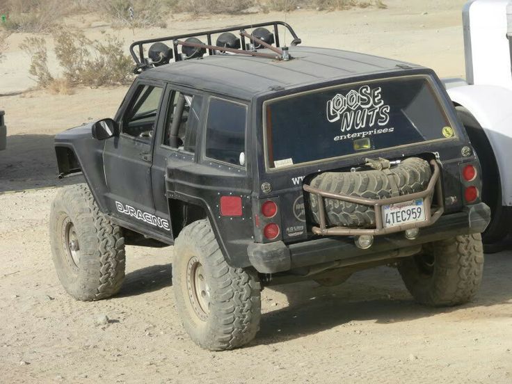

I'm going back and forth on how I want to run the cage and spare tire. Originally I was going to keep most of it internal and run the spare on the floor and through the hatch kind of like this.
However, with the 98 having a nice and clean interior I'm contemplating running it outside so that I can keep the extra room.

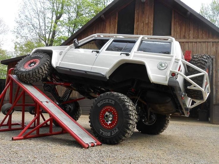

Would never hang 300lbs of tire and steel 5 feet past rear axle centerline . The exo cage is a compromise but serves a useful purpose and still puts less weight in a bad place than that tire carrier location ...lol...Reminds me of an XJ Penny Racer ...lol
Well the tire laying flat on the floor and poking through the hatch keeps the weight lower and more over the axle than having it vertical behind the hatch like all traditional tire carriers do. You also maintain better visibility out the rear. The obvious drawback of course is losing cargo area.
But it's ok to hang a winch bumper, winch and the weight bias of the engine over and ahead of the front axle? How is having 300 lbs at the rear of the jeep a "bad place"?
Of course I'm speaking in terms of what Dutch is wanting to do, not hanging a 44" Swamper and associated tubing to hold such tire out back........
Seems to me a rear mounted spare and carrier helps balance things out.
The biggest problem I've seen with rear tire carriers, is weight bias (though not super high), and dragging on every ****ing thing.

It is a poor place to put weight , but not the end of the world for a daily driver with need to have free space inside for people and gear . I have never owned a non dedicated trail rig so I have no need for utility in the build . I have seen a handful of these set ups eat the rear big when trying a steep climb they drug and ate going up and when the climb failed that rear went right Into the rocks...hard...rig stuck and everything hanging off beat up . But if you need the interior space and drive to the trail it beats a roof mounted spare .
