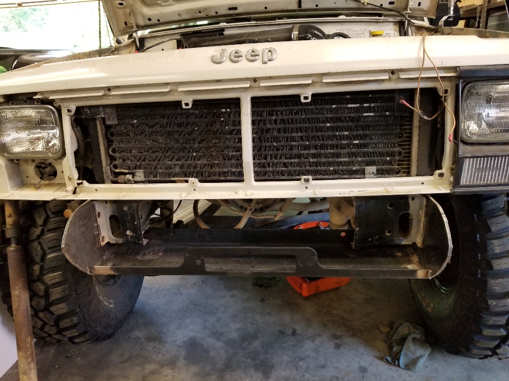

Finally putting the winch on. Wait I'm to broke to buy a bumper so I have to build one.... Sucks being broke...
It's nowhere near finished

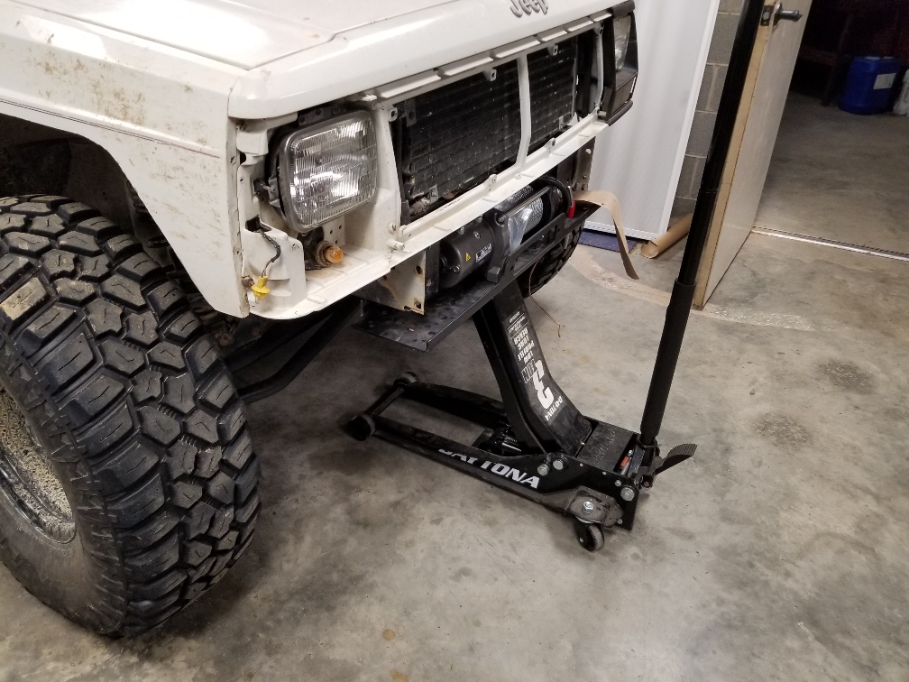

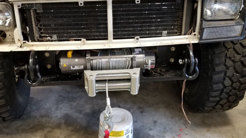

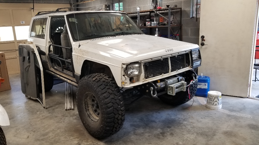

Mostly finished winch plate...
That is a beautiful installation. With a hawse fairlead, you may be able to re-install the OEM or similar bumper.
