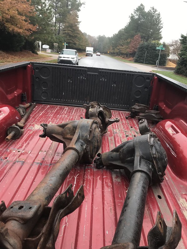

Well I had a pair of axles follow me home this past Saturday. Bought two SD D60s for 400. The build up of one for the front of my rig will start in January. It won't get swapped in until its completely rebuilt. I'm still researching parts and pieces. The biggest question I'm asking myself is whether I want to go 5.38s or keep 4.88s. I'm buying new tires next week and will be going with 37s. 5.38s would be nice if I decide to jump back up to 40s but would require I regear the rear as well.

Haha yea I know. I keep breaking shafts in the 44 so it's time for something stronger. How are your axles coming along?
Slowly. I ordered steering parts. I'm about to roll out the entire front suspension and both axles to mock up the new stuff. After that will have to be a 3 link kit from barnes or ruff stuff with 4.5" RE coils.
Work has been killing my free time so things aren't moving as fast as I originally wanted it to :rolleyes:
I’m undecided on how to build this one. I’d love to build it outside of the jeep and then just roll it under but to do that I’d have to go with a kit that locates all the brackets for me. I’ve been eyeing the artec system but it’s pricey. I’m going to try to stay with the 3” coils I’m currently running but I’ll cross that bridge when I get there. I’ve got some 4.5” RE springs sitting on the shelf in the shop if I should need them.
If I could make a suggestion, go with ruff stuff brackets. They are better designed and not as bulky. Barnes brackets are huge compared to ruffstuff which makes packaging everything more difficult.
Yeah ruffstuff has some good stuff. I don't even think I am going to truss my SD D60. I will probably weld the tubes to the diff, but that thing is incredibly beefy. I don't think the artec kit is worth it. I want my coils centered right on top of the axle tube.
Funny you should mention the coils centered on the tube...The initial image for the artec truss shows the coil buckets in the factory (in front of the tube) configuration but the image in the description shows it centered on the tube. I had never noticed the first prior to your comment. My coils are currently centered on the tube and I want to keep it that way. I may call Artec and ask about this.
Edit - Nevermind. I figured it out. The image in the description shows the JK version. I'm going to compare the two as the JK version is more appealing and cheaper.
