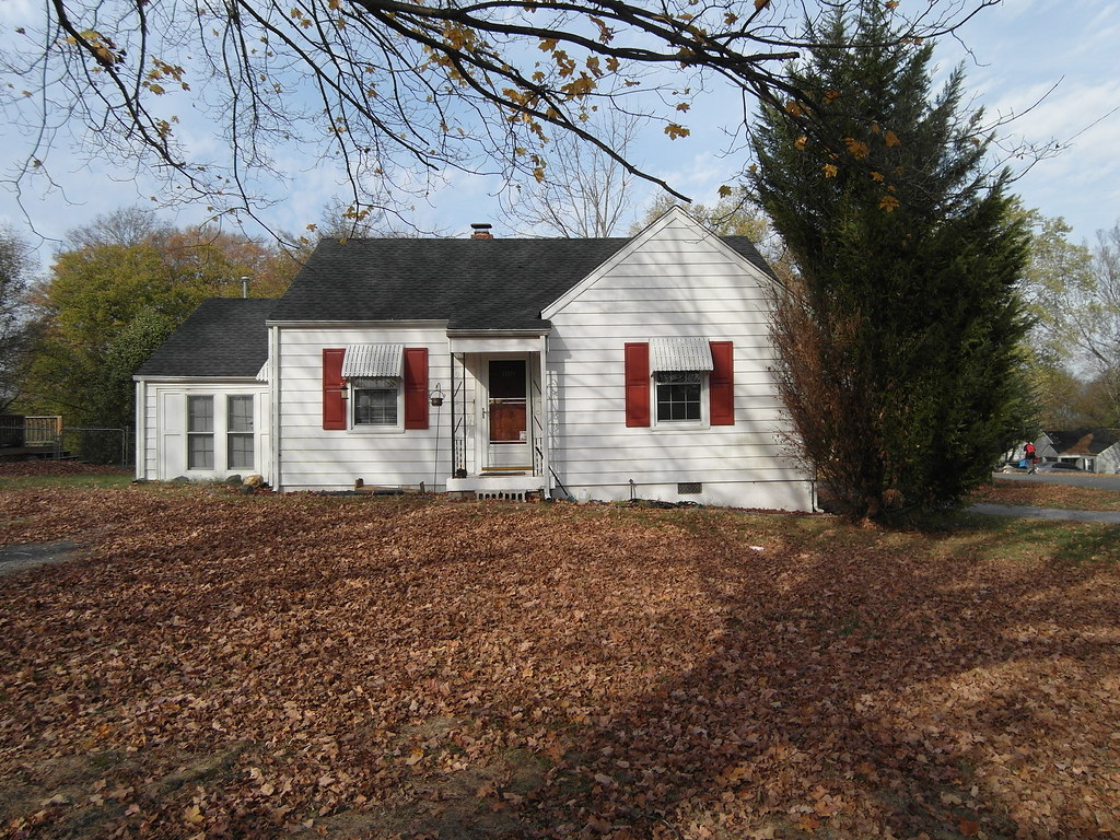

Hey, look! A picture with a real camera! Pictures do not do it justice. It looks straight as an arrow. but it aint.

Understandable.
So, I'm thinking the only thing that would be reasonable would be to take it ALL down and start over... I could have it all down in less than an hour or two. Putting it back up may be a little more time consuming by myself. Expecially with these crazy ass rain storms we've been having.
If you were anywhere near here I'd tell you to:
* buy an MJ
* load it with the required lumber
* call me
and we could toss this together pretty fast. It's not as difficult as it looks, especially with 2 or 3 people around. Could even add eaves at the same time, though you'd need to make the walls taller to do it properly from the look of those windows and doors. Not difficult, I did it when I redid my bathroom roof - ripped everything off except for the ridgeline, raised the walls a few inches, then added new rafters and slapped the decking and shingles down.
Do you EVER get snow loading, at all? If no, I would probably measure and buy premade standing-seam steel roofing, get it delivered. Even if you have to replace all the rafters (go 2x6 or 2x8 if you do, why miss the opportunity to strengthen it?) and decking (check your local codes, I'd probably use 5/8") you could get out of it for a few thousand dollars all told. I think I have about 4k into my roof and that includes decking, some new rafters, drip edge, nails, tools (two nailguns, ladder, circ saw), ice/water shield membrane, tarpaper, shingles, peak vent rolls, AND hip/ridge shingles.
Yup! and If I was doing all that to it I'd be extending it out over the deck too. For some reason I don't think an MJ could handle that load. lol
We get SOME snow. Last year we got about 4 inches one time. It's usually not enough to stick to the ground.
Lowry - why'd you cover up the existing siding? I have siding that looks like that on my house, though mine is aluminum. I love it.
