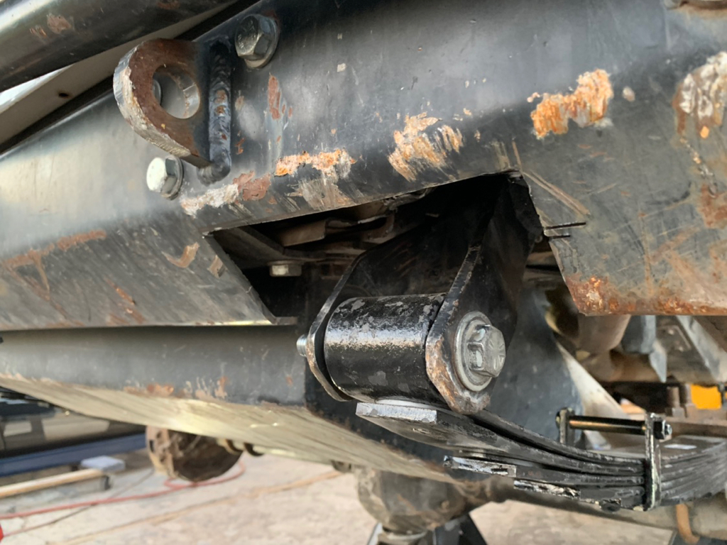

Swapped in some re 4.5” leafs and metalcloak 6” tj coils. Somehow i am missing my coil isolators so i ordered some. And these leffs are like 3” longer than my iro 3.5” leafs so i need to adjust my shackles and do some clearancing on my bumper. At least its not lopsided anymore. Ill be swapping in my tnt lower control arms and adjusting wheelbase a bit. And adding my traction bar after i drive it a bit and get the leafs to settle in.
Yeah I dont know why the 5.5” leaves are so much longer than the other leaves its weird.
I was reading around online and found that these are 55" mains on the RE 5.5" leaves. So a boomerang shackle is a must , RE 2705 or something like that.
Im tempted to order the RE boomerang shackles just because it would be cheaper than spending 300$ on getting these main leaves shortened, but then I loose the slider boxes, so I will probably end up shortening the mains

regarding the leaves, I recently installed the same set of leaves prior to renofest and have almost no uptravel with the slider boxes since these leaves are so long - 55" mains versus a 52" main. Im getting rid of the leaf sliders since it would be too expensive to have these leaves cut down and custom length mains and I am going back to RE boomerang shackles. Also, the slider boxes are mangled to hell even with the additional bracing I welded on so I am blowing out the delrin pucks pretty quick anyway.

- relocate shackle pivot points
- clean and grease shackle joint
- clearance bumper for shackles

Only pics i have are of the bumper clearancing i did. Pay no mind to the hackery. An air hammer cutting tool, grinder with a cutting disc, and a big ass hammer were all i used. And i was in a hurry as the sun was setting.
