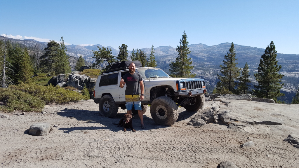

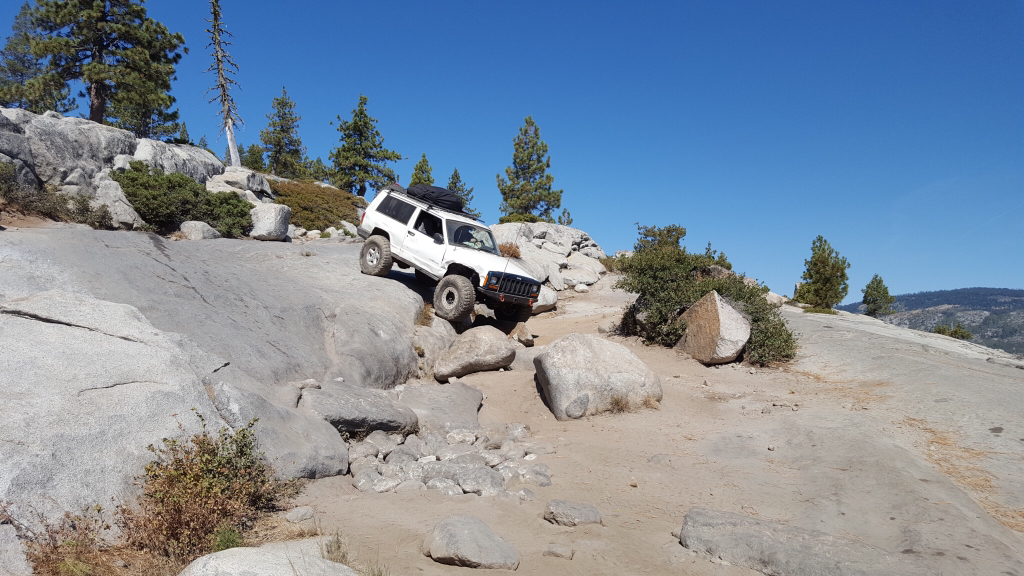

And because threads suck without pics here are some pics from the rubicon with my dad
Cant wait to see this thing done with super built 35 spline 44s !
You and that 30 have had a love hate relationship.
Can't wait to see this thing all done up.
