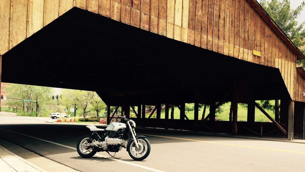

the bike is all together and riding now, went for a little ride around town and ran some errands this morning, passed a cool covered bridge on broadway and had to stop for a quick picture
Lol..... that "bridge" is a stones throw from my house...... bike looks good!
