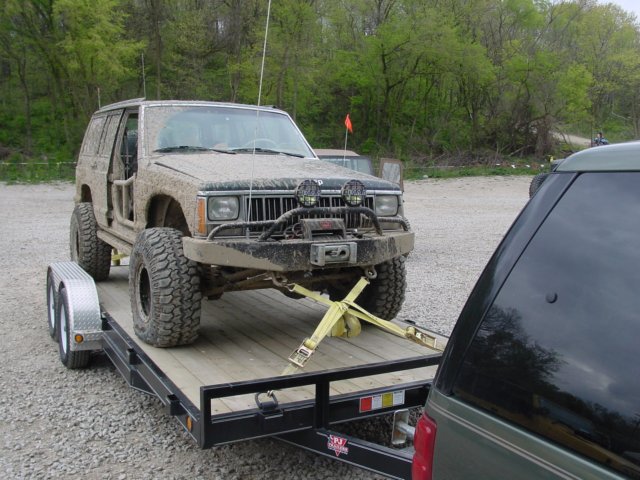

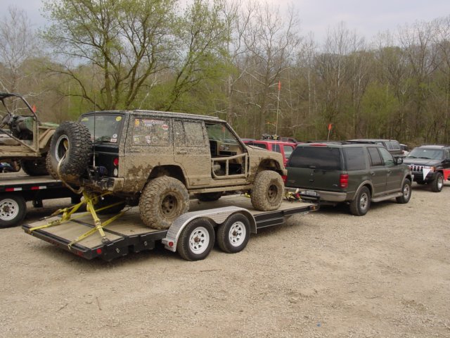

would pictures work for ya
pretty much what was already explained .i used 2 ratchets to the body front and back then two chains around the axles.
somebody correct me if i'm wrong, but aren't you supposed to hook to the body/frame and NOT the axles- because the bearings need constant preload otherwise jolts up and down on them while on the trailer and the jeeps axles are not rotating can damage their bearings by hitting constanty in the same spot of the bearing.-???
i don't run my chains super tight .they are just there so to speak.they have tension but not alot.i use my straps for all the holding power the chains are for just incase emergency stopping
