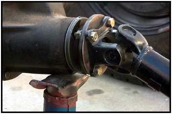

The issue with the flange based setups is that they add length to the pinion and I don't want to have to shorten my "new" shaft. Also, they don't really have benifit much I guess. Look at this picture and see what you think. I think the u-joint is still very exposed.
I am thinking I might take the time this weekend and try to fabricate something like this and tie it into my truss the same way. Obviously I won't have the bolts around the pinion so I'm not sure I like the idea. I need a way of really securing it.
tieing/building it off of the truss seems to be about the only way of going about it. the Nth degree setups are cool, but like you said I dunno if I really trust them that much with what you'll throw at it. I was gunna suggest something like Keith did cause thats about the best way to get a pinion skid, but I understand the bitch of welding to a center section thats already been geared and everything. Does your 60 have and flat casting ribs to support the pinion? With it attached to the truss, you could maybe tie into the ribs as area around the pinion to sucure the skid.
Or, using a flange yoke, you could fab up and skid thats welded to the flange or uses the bolts and comes out enough to protect the u-joint :dunno:
How about some sort of clamp that goes around the housing with the same sort of pinion guard?
I agree with you about the flanged yoke thoughts.
It does, but they are pretty thin, IIRC. I'm going to have to lay under it and figure it out.
It would have to be pretty big and cone shaped to clear the yoke during drop.
This is what I was thinking... use the bolts for ease of repair. Agreed that it would become a rock anchor if you made it big enough to actually help at all and still clear while at the top @ full droop.
whamo
i was thinkin about making something like that. maybe use a couple diff cover bolts and a big u bolt around the pinion area of the housing. i have never broken shafts, just exploded yokes and the axle end u joints, and every time but 1 it was the result of coming down on a rock the wrong way or knocking the cap "keepers" off previously
Bill, my other idea is basically something that clamps around the pinion housing with a bolt on each side rather than a u-bolt that would hang down more...
edit: as i was typing that Sam posted about it too. I don't think I'd use a u-bolt to go around the housing. that would just hang down farther...
i was thinking the bottom of the u bolt welded to 3/16" or 1/4" awesomeness. you dont need anything to hang below it.
edit: or hell, even just some bolts and a clamp with a concave round bottom on top
