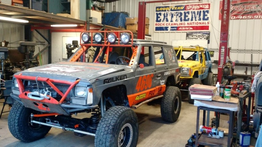

Apparently it's a 4600 class party at the shop this weekend. 4643 is off the lift and 4696 is on.
And we kinda acquired this thing as well, and will be prepping it to race at Glen Helen. "the most disturbing part of all this, is that this thing actually qualifies for the term "racecar""
Managed to not take a single picture of our car this weekend; but 4643 is all buttoned up.

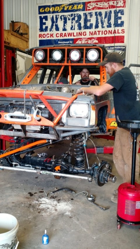

Dallas spun up a custom AN fitting to swap in a new steering box.

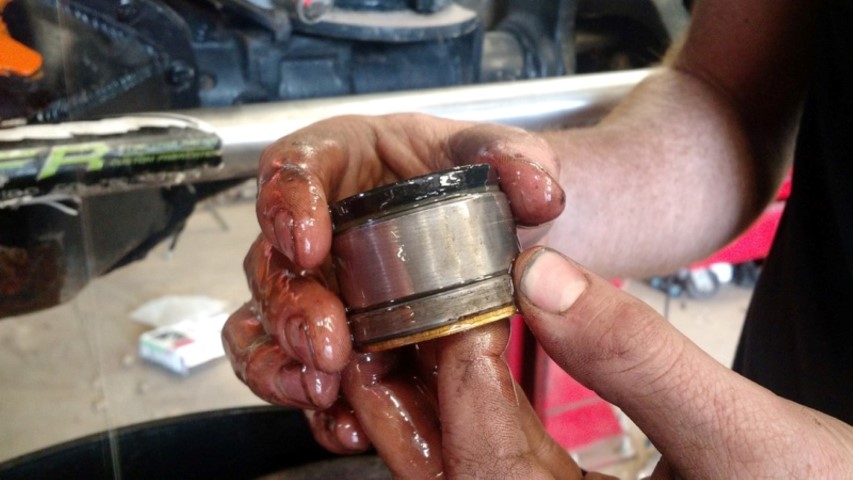

This is the bearing and seal assembly from the sector shaft of an AGR steering box. The seal uses a small o-ring in a steel carrier (the lowest part before the washer) that had to be replaced.

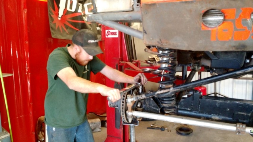

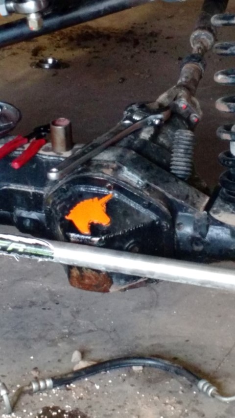

Snugged up some balljoints

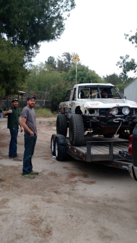

Also went and loaded up the Poor Runner for the Ridgecrest boys to race as a second car!
Doesn't seem to need any prep, just fresh gas and go.
