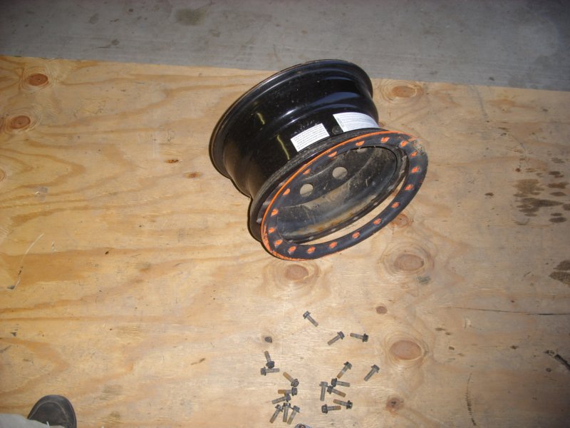

One Steel, 15x8.5 MRW bead lock. 18 bolts per bead lock, steel wheel converted by a factory, no grinding, no leaking, no siliconing.

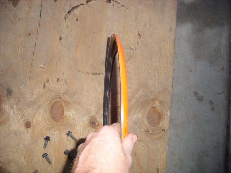

Note the outer ring is a stamped piece and not a flat piece. I think this adds to strength BIG time compared to the DIY flat outer rings.

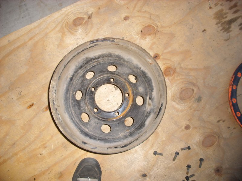

the back side with the normal, steel wheel inner bead -

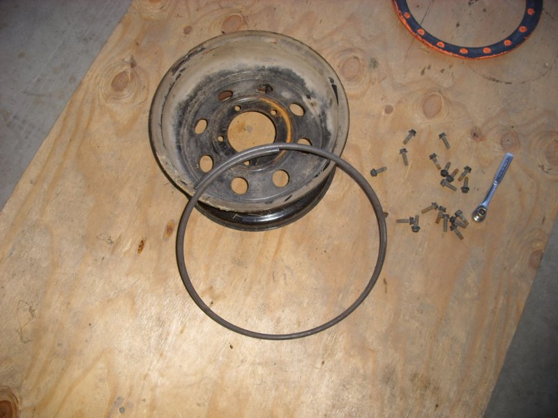

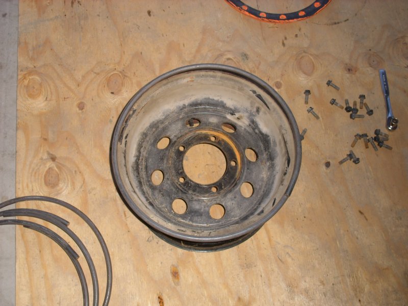

the ring (16.00 each)
1/2" round stock rolled into a ring, overlapping for approx 6" in one piece.
pretty close to a 15" rim as delivered -

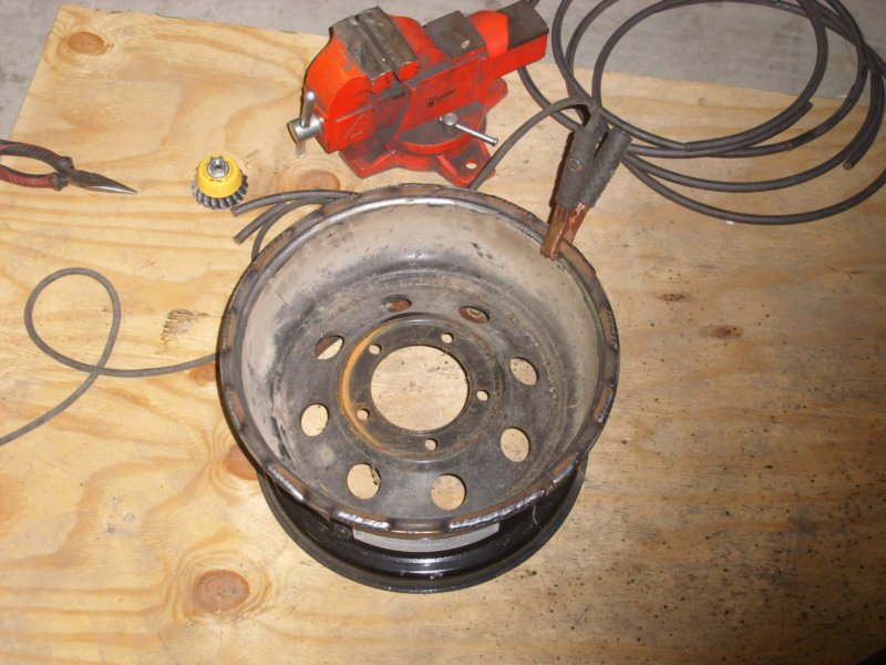

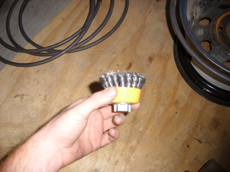

Used a wire wheel for the angle grinder to take the factory powdercoat off - worked AWESOME -

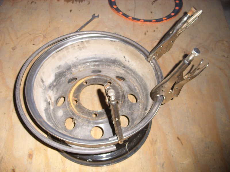

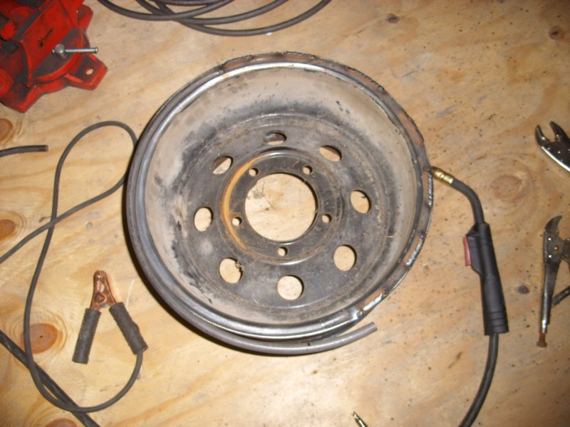

grabbed 3 pairs of vice grips, and clamped it on -
started welding, moving the vice grips, and only welding behind the vice grips.

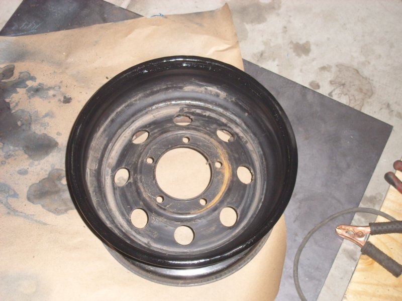

the first one I did, I fully welded the outer ring, and did 4 welds on the inside of the wheel to prevent the inner bead from 'rolling'.
I ground this smooth, and painted it -
the other 4, I decided to weld ~2" every 4" on the outside, (2" gaps in between welds) and then weld on the inside in-between those sections. I didnt grind at all, and just called it good.
