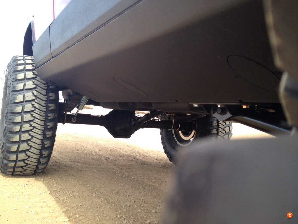

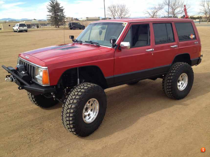

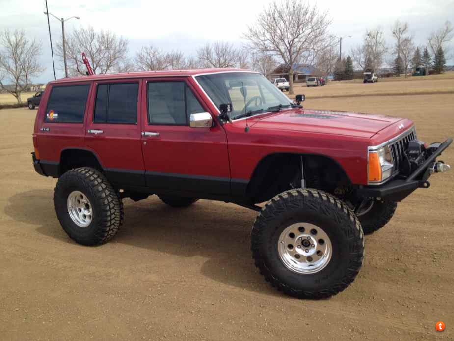

Nice! Details please, tire size? Especially interested in that intriguing armor.
1992 XJ
6" Iron Rock Offroad LA lift
Blistein 5100 shocks
35x12.50-15 Goodyear MTRs
Artec trussed Dana 30 w/4.88s, ARB locker, Ruffstuff diff cover, and RCV axles
Chrysler 8.25 w/ rear disc conversion, 4.88s, ARB locker, Ruffstuff diff cover, and Yukon axles
Warn Zeon 10s winch
Rigid LEDs
Hooligan Offroad (hooliganoffroad.com) Boatsides
