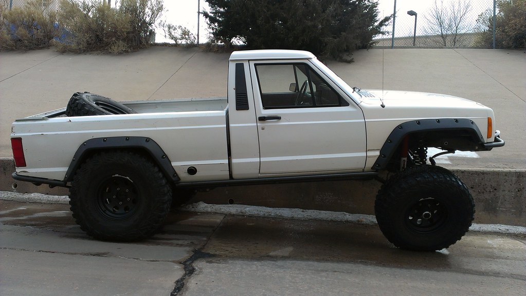

I was driving over to my friends house to trim the new fenders and re-install the front flares when i ran over a little pile of snow with the right wheels going about 25mph. I was just jackassing around enjoying how soft the rear is now, but as soon as i ran the snow over i knew something was wrong. I pulled over to see what happened and the right shackle went inverted, i had no highlift and my friends house was only a few blocks away so i finished driving over there and we jacked the bed up and the shackle went right back and the leaf spring looked to be undamaged, but heres a pic of when it was inverted

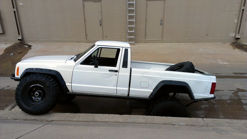

After I fixed the shackle i got the flares back on the front and heres a side pic of the ride height how it sits now

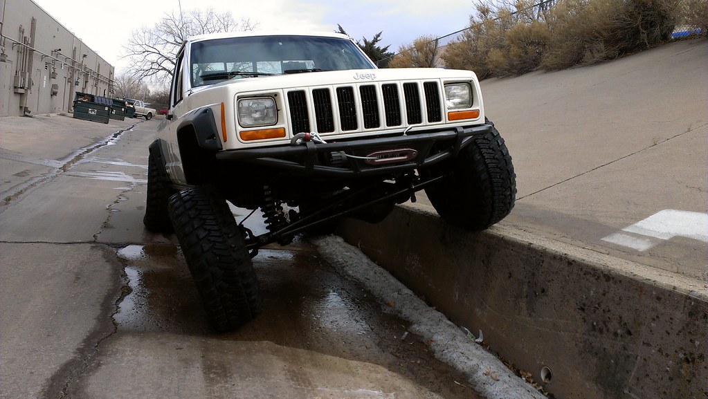

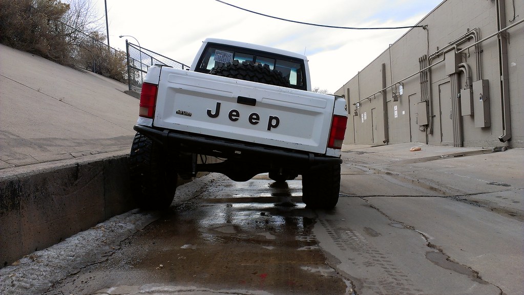

Frank Z pulls through once again! Serious Offroad had cheaper prices on bilsteins then most of the big vendors, frank called me when there was a little hickup with paypal, and i had my shocks in 3 days! I flipped my shackles around and bolted the shocks on this morning then went to lowes to get some pieces of steel to make shackle stops out of and picked up 200 lbs of sand to throw in the bed to lower the back of the truck a little.
On the way back from lowes i decided to stop behind king soopers and flex out the jeep again now that i have everything sorted out on the truck...heres a couple poser shots with one side of the sway bar disconnected

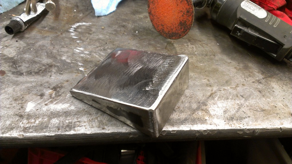

I drove up to my friend aarons shop in breckenridge yesterday to fab up some shackle stops. We started by putting my truck on the lift and raising it until the rear end was at full droop. Next i tack welded plates on the front of my shackle hangers to box them in and built stops onto those...i ground the tack welds off the frame and removed the stops once they were all tacked together so i could fully weld them on the bench then grind them smooth.
Heres one of the wedges welded on the shackle hanger/frame sitting pretty much at ride height
And here is how the shackle sits against the stop at full droop

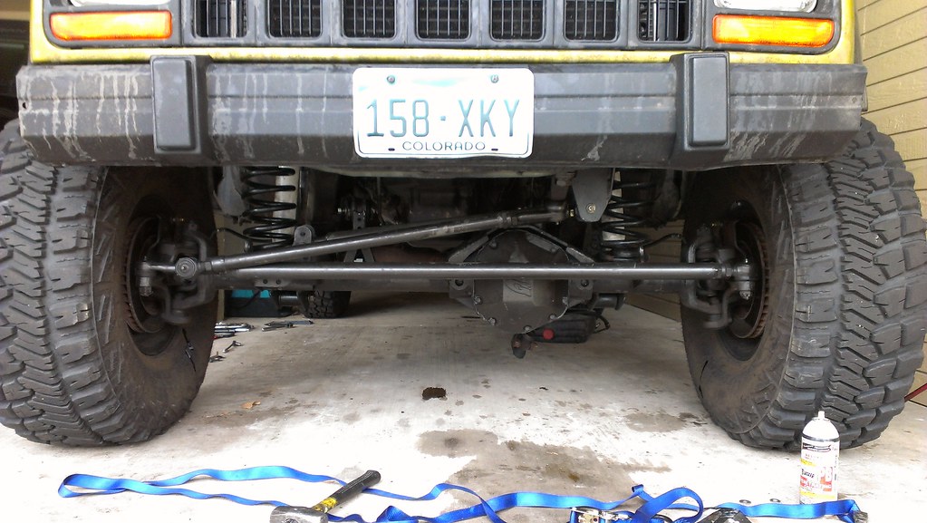

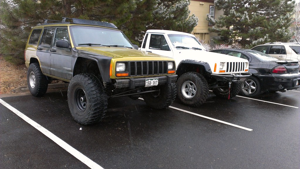

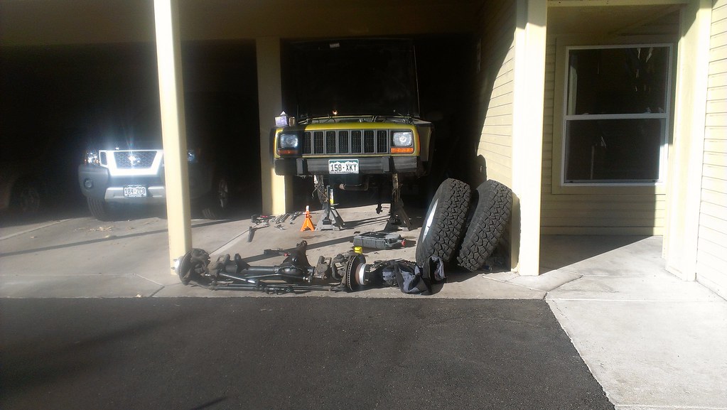

Your right there would have been...i guess i cant fool anybody! But this did happen:
Now theres a full width hp dana 44 with 5.13 gears, 35x12.5 mtrs, and one ton steering bolted under the front of my XJ:exclamati The dana 30 and km2s went under the mj. It was in the low to mid 30s all day saturday and snowed a little in the afternoon, but i worked all day on swapping the two axles in my apartment parking lot with only hand tools and jack stands...BY MYSELF:yelclap:. The only thing i had help with was my girlfriend pressing brake pedals for about 15 minutes to bleed both brake systems. It took me just over 8 hours to get both axles pulled, swapped, half-ass aligned, and both vehicles driveable again.
