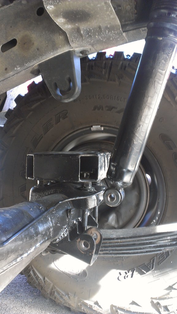

I figured out the stiff-ass-rear-end problem!!!
On my lunch break i loosened all the leaf spring and shackle bolts till they were just snug, then i unbolted the bump stop pads from the axle and took it around the block. Nothing changed!!! It still rode exactly the same, stiff as crap.
So after i got off work i decided to unbolt the bottom of the shocks and just let them dangle on my drive home. I unbolted the drivers side shock , popped the bolt out, and let it dangle. When i got to the passenger side i took the nut off, but the bolt wouldnt just slide out of the shock bushing because it was under a bunch of tension. So i pried on the bolt while i unthreaded it and when it popped out of the bottom of the shock the whole back of the truck sprung up!
The shocks fully extended are about 4" too short, just at ride height....so they are probably 8-10 inches too short overall. After unbolting both shocks, now the back of the truck is sitting 4" higher than it was before! :laugh:
http://www.flickr.com/photos/77129649@N05/8350828145/
You can tell in the pic that the back was sitting a little lower than the front before, which was alright...i liked the stance. It rides a ton better but now the back is a few inches higher than the front. Its too dark to get a pic right now though

Told ya it was something to do with the rear shocks.......... :shhh:
Glad you got it figured out. :thumbup:

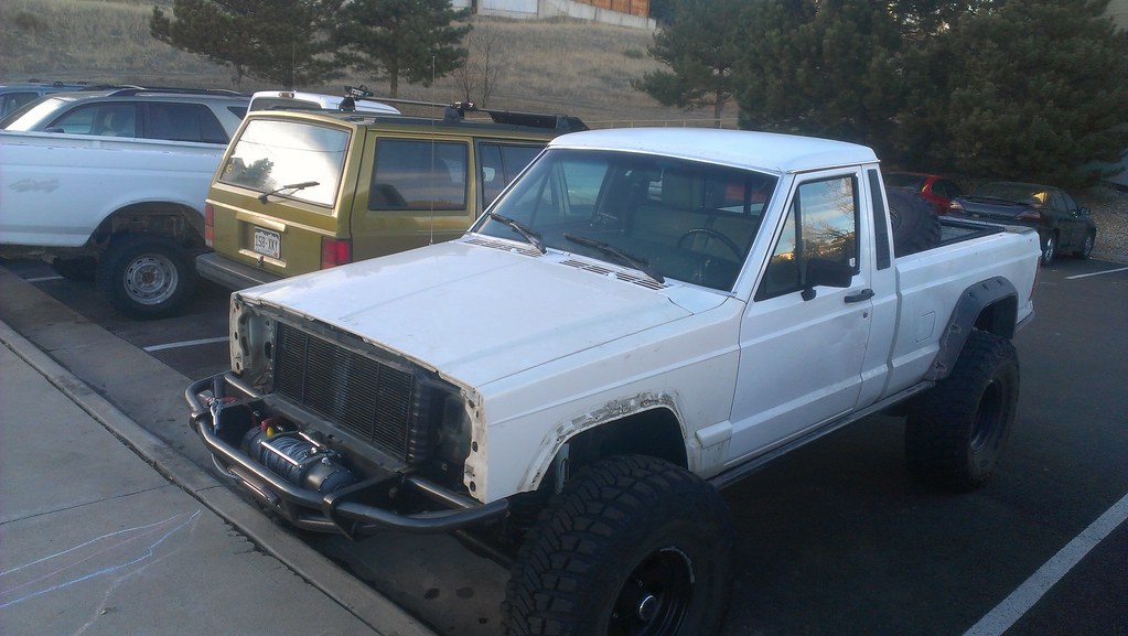

I Finally have a weekend off...and the weather is nice....at the same time! So i took advantage of it and worked on the truck a for a couple hours this afternoon. I got a front end off a white 99 xj that some chic was parting out on craigs list. Its the offwhite instead of the whitewhite like my truck but its not far enough off to bother me, plus i got a smoking good deal on the hood, header panel, and both fenders.
Heres the little one helping take the front end apart, she unbolted the old header panel almost completely by herself, i just had to start a couple of the screws that were too tight and unplug the electrical connectors:
I got the fenders and hood on and all lined up pretty good and decided to just swap and modify the header wiring inside and bolt that on tomorrow since the sun was starting to set

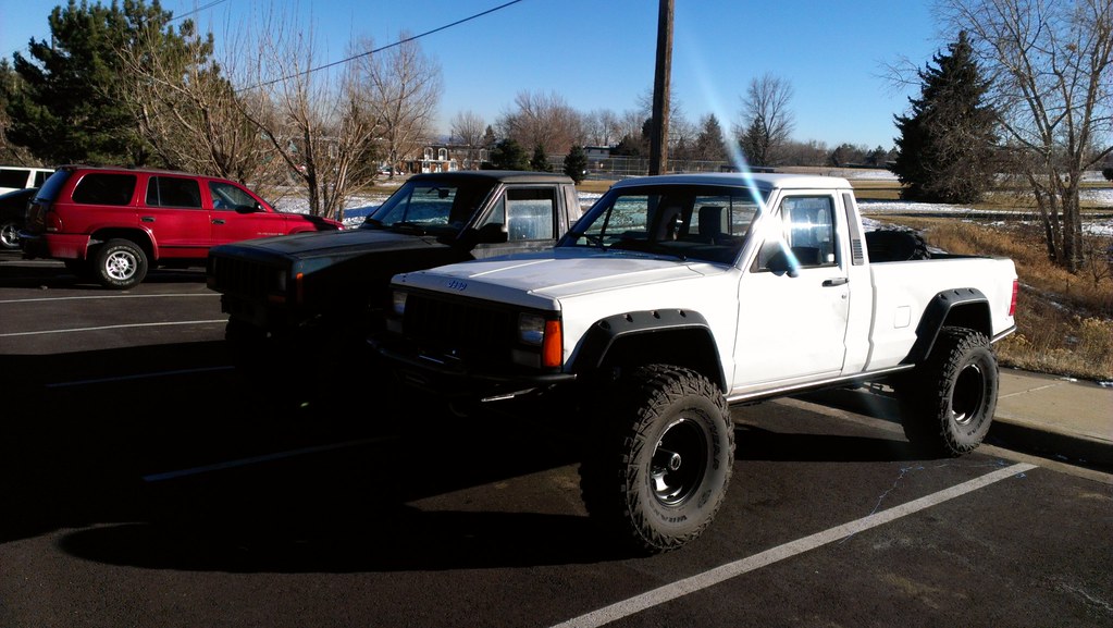

This morning i got the wiring harness modified and bolted the header back on, man my jeeps look good parked next to each other
[url=http://www.flickr.com/photos/77129649@N05/8398605677/]
I put the bump plates back on the rear axle and snapped a quick shot of how short the rear shocks were before i unbolted them completely
[url=http://www.flickr.com/photos/77129649@N05/8398606525/]

:thumbup:
Wow! That looks great!
