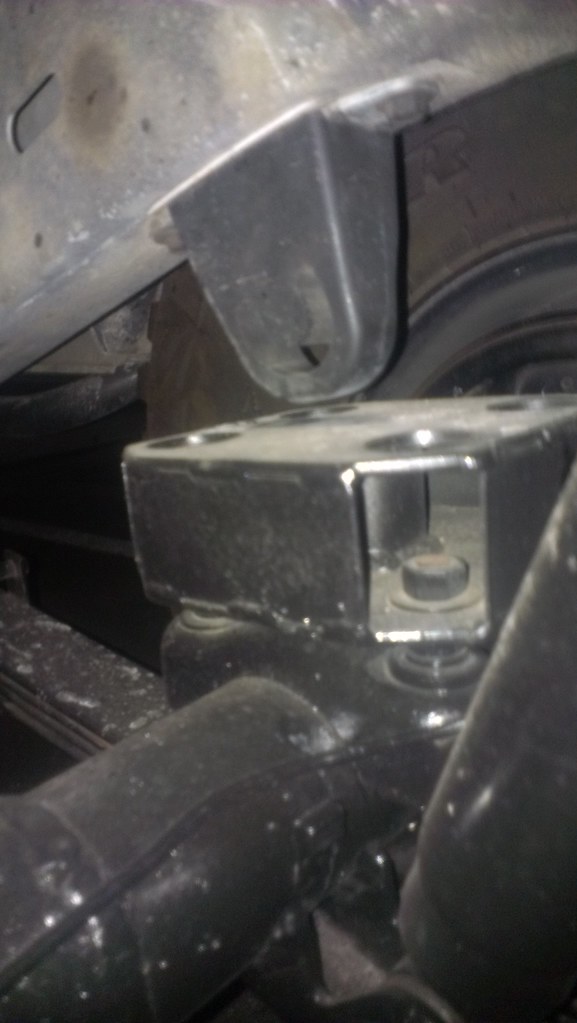

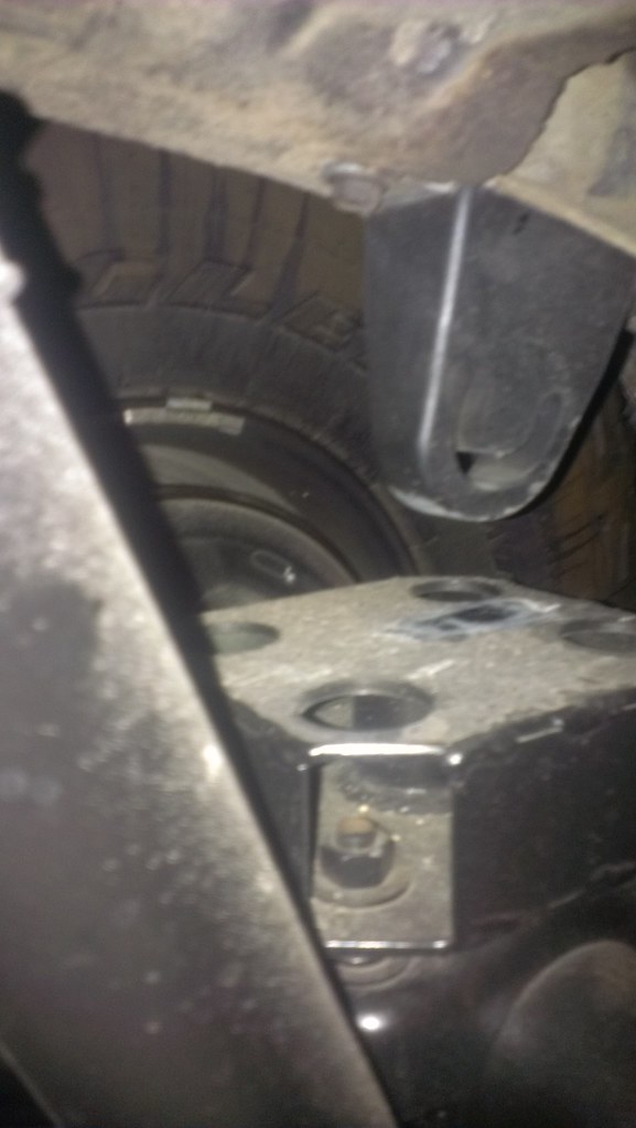

Then looking forward, the main problem became apparent...On the drivers side theres only about 1-1.5" of available uptravel before the bumpstop pad will contact the bumpstop. And even worse, for some reason theres only about a .25-.5" gap between the pass. side bumpstop and pad.
Drivers side:
IMAG0132
Passenger Side:
IMAG0133
Im glad to discover that its a simple thing causing the problems in the rear. But im bummed to realize that the right leaf spring has already sagged about an inch more then the drivers side for some reason. They are Rustys springs, which i know dont have the best reputation for quality, but for only having around 3-4k miles on them it seems like they shouldnt be sagging this much already. I looked the spring over pretty good and didnt see any broken leafs in the pack so i know its not that.
P.S. after i got home from wheeling on sunday there was a little wet spot from fluid running down my passenger side framerail, and after investigating i fount out it was gear oil coming out of the t-case vent tube that is coiled up in the engine bay right in front of the heater core Is there anything wrong you guys can think of that would be causing this, or is it just normal from the t-case heating up from highway driving?

Wonder if right is more flat from being parked flexed out. most park with driver front up. (just saying)
but definitely cool it is an easy fix.
Re: where have all the good cherokees fs gone
Check the spring eye bushings. Skully had Rusty's leafs, those bushings might have lasted a year at most.
drove it out of my parking lot just to make sure it wasnt bound up being parked, but the bumpstop on the passenger side was actually touching when i stopped in the street...maybe the shackle bolts are waay to tight causing the springs to stay bound up?? idk i didnt bring home any tools to check, but i will tomorrow.
And i did a little research, i guess clocked and or flipped 300s are notorious for puking oil from the vent. Didnt dutch have a 300 in the YJ? Did you have any issues with this dutch?
