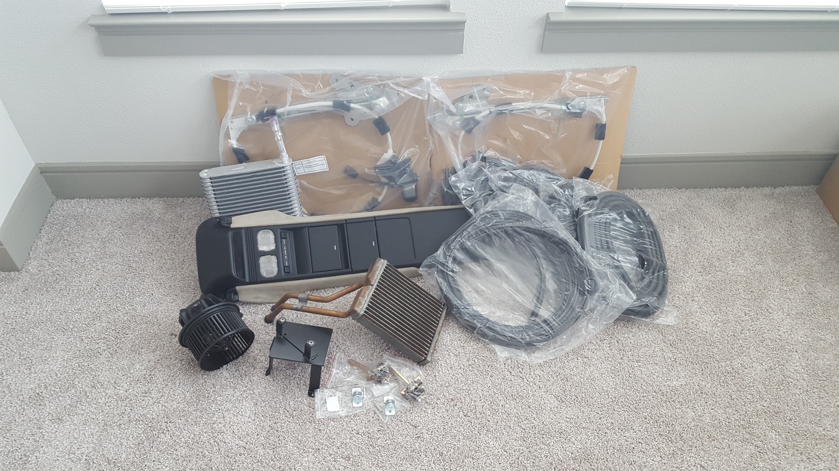

Admit it, you were jealous of my overhead console. It's ok, I'll let you join the club. :D
Yeah, I really lucked out there. I'm so glad Putzer trolls Auto Trader, because I never would've looked there. I mean seriously, who the hell still uses Auto Trader? That's like still having a phone booth on the sidewalk. Didn't those all go away in 1998?
No joke, havent used autotrader since high school. Figured with CL who the hell would pay to post an ad.
