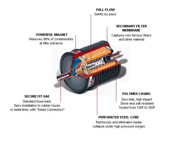

In addition to annual PS fluid change and flush, don't forget to install one of these filters on your PS pump return line, this magnetic unit traps fine metals and reduces pump/gear wear. Works on tranny's too.
Found mine locally for $19.00.
The MAGNEFINE filter extends the filtration spectrum to provide dual filtration that is designed to be completely effective in removing damaging ferrous metal particles from automatic transmissions and power steering systems.
When the fluid passes within the effective range (5mm) of the powerful magnet, the MAGNEFINE filter quickly attracts all the hard damaging ferrous particles, even down to an incredible sub-micron level stopping the "chain reaction of wear".
(University test show removal of harmful ferrous metal particles to 99.9974%) The secondary filtration media, removes remaining non-ferrous materials (i.e. copper, aluminum, dirt, clutch material)
The worldwide patented MAGNEFINE dual filtration filter is the only effective form of filtration that can provide dynamic small particle extraction while maintaining full line flow capabilities for automatic transmissions and power steering systems
  • EXTENDS TRANSMISSION SERVICE CYCLE
    Continual cleaning of the transmission fluid actually produces cleaner fluid than the new fluid you put into the system. Major OEM's recommend adding 10,000 miles to your service cycle with the use of the Magnefine filter.
  • EXTENDS COMPONENT LIFE
    Filtering out ferrous particles 3 microns and up, will enhance componet life by 7 times, according to Sayles & Macpherson.
  • DESIGNED FOR EASY INSTALLATION
    Easily installed on both hose and steel lines. Magnefine has simplified steel line installations with the use of its "SMART CONNECT" fittings.
  • SIMPLIFIES TRANSMISSION SERVICING
    No more dropping the pan to service the pan filter at your normal cycle. Pan filter servicing is recommended at 100,000 miles. Servicing may be accomplished by evacuation at the inline filter points or by draining.
  • STOPS "CHAIN REACTION OF WEAR"
    Removing the ferrous particles in the 3 to 15 micron range with the powerful magnet, stops the wear and break down of the stabilizers.
That's cheaper than the inline filter I run from Lee Mfg. I also run Redline synthetic power steering fluid. Between the synthetic and the filter there's no need to change fluid often, which is much harder with hydro assist.

I've also thought about inline filters but never really felt the need for it. I'm sure they help get the particulates out of the fluid and prolong the life of the pump and gears, just haven't ever done it.
