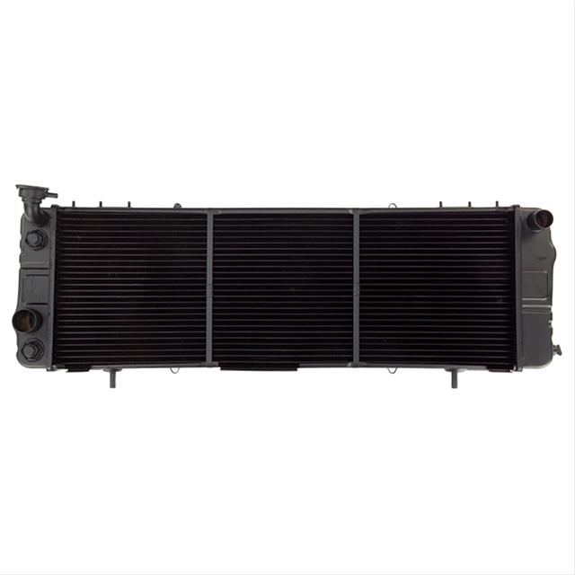

Copper/brass, no plastic. double row, not single like my mopar aluminum and plastic radiator. Much cooler running now with this new radiator.

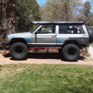

Hesco water pump. 90 XJ, 4.1l, 11-1 HO head, Hesco cam and water pump, cheap two row aluminum radiator, bored t-body, Mopar header, 2.5" exhaust, not shown full roll cage, it's a heavy bitch. Moves out quite well at 6k feet, I only need the e-fan in stop and go traffic when it's hot, or when I'm in 4-lo going uphill at 11k feet. I put in the hood louvres because I thought it would run warm after the engine build. It's the coolest it's run in the 32 years I've had it. Rock rails from the very first NAXJA Moab trip. 20230506_124054.jpg

I've got the mishimoto performance rad, which should be the same thing
