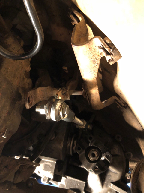

I just finished swapping a Rubi case into my 96 XJ AX15, and there was no way to get the factory 231 Z linkage to work. The 231 lever swings from the bottom, and the 241 is from the top. I even tried fabricating a new adjustable linkage rod with some heims and threaded rod I had, but I can only get 2H/4H/N or 4H/N/4L. The factory bracket is janky with worn bushings so I think I’m going to have to swallow the heartburn and order one of these snazzy cable shifters.

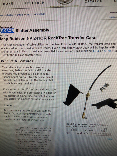

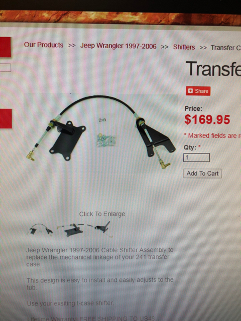

The Novak SK3XR and the Savvy Offroad SAV-241S appears to be identical. Savvy is $10 less, and offers free shipping. Any advice on which one is better, if there even is a difference? Any discount codes for NAXJA, Pirate, Jeep, or Cherokee forums?

i use the novak , top quality for sure, 10.00 difference i would buy the novak at least you know what you are getting. never heard of the other brand. does boostwerks make a shifter linkage setup for that tc conversion ? would be cheaper.

I talked to Boostwerks and they said they couldn't confirm if their kit would work or not, and relayed me to Novak, which led me to starting this post.
I saw their setup and since the 241 already has the selector upward, it's really just the piece that bolts onto the bottom of the cab shifter, and then the linkage between (which I kind of already made myself). The problem is how bad that angle is, looks like it would definitely bind up.

Bearings and chain seemed tight, fluid looked clean, so I just bolted it in. Jeep does move under it's own power, just fighting this shifter linkage.
The only modification I needed to do was notch the trans mount plate, that bolts to the bottom of the AX15. The girth on the input side of the 241 is much larger than the 231, and the bottom bolt wasn't even close to clearing.
