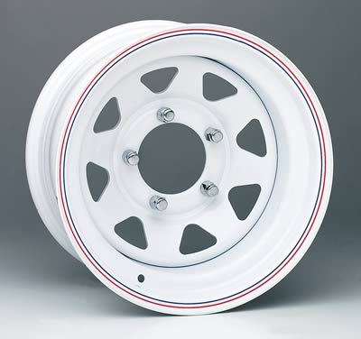

you will love those wheels... the worst part about them though is the shear weight..... its alot of force and weight for that d44 your gonna use..... but they are pure beef

i also picked up a set of these wheels...
will do a weld on beadlock kit when i switch to 40's (end of the year or so), that'll cut down on weight
actually youd be surprised it prob would weigh the same.
so with the white wagon wheels are you going to run two different wheels/tires combo?
basically im using the 37's to get everything on my jeep set the way i want, since i got them so cheap. later on down the road im going to get a dana 60, and build it up to handle 40's. then ill swap that in, and switch to the white wheels w/ 40" super swampers. also, i go to the jeep jambo, and they limit you to 37" tires, so ill still be able to go.
