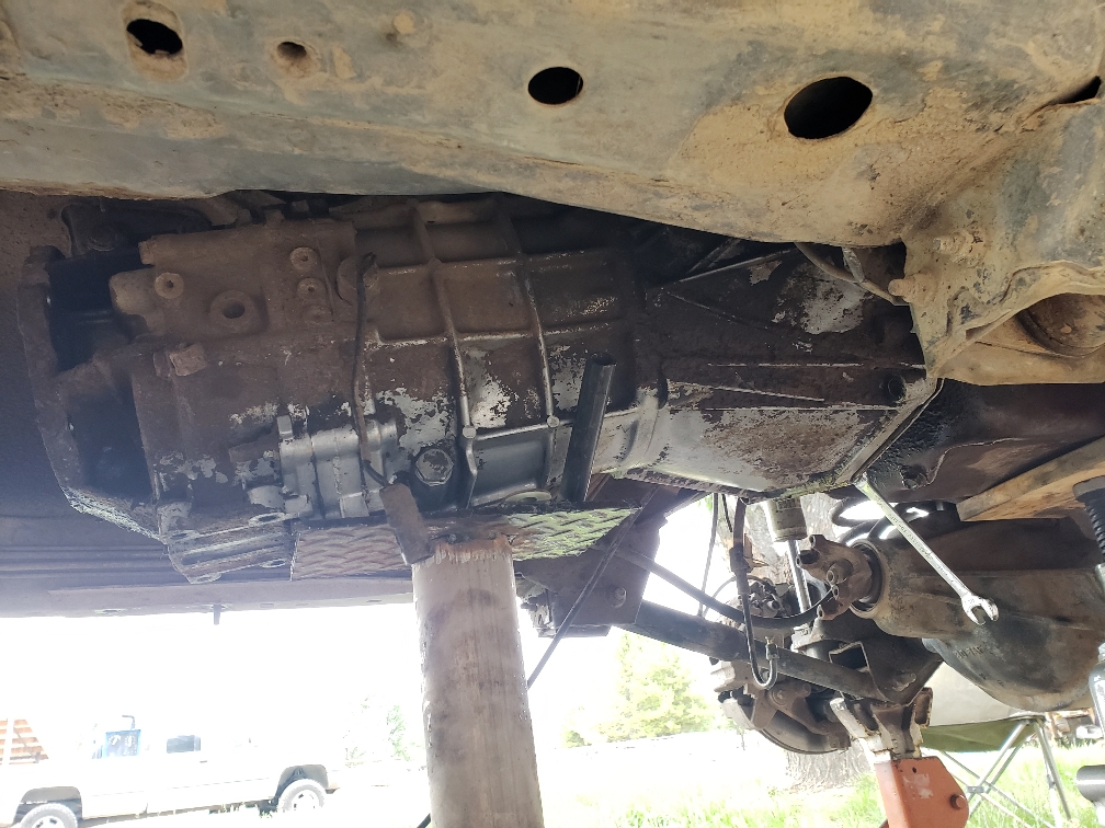

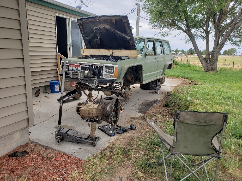

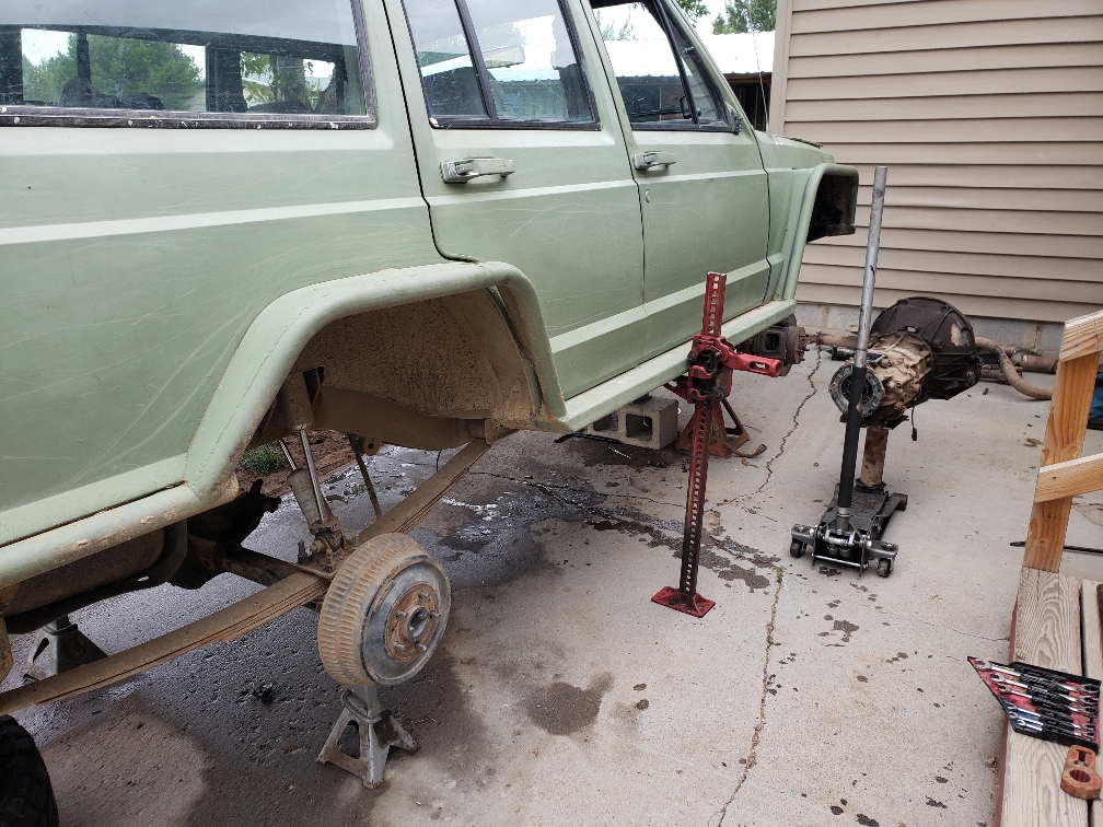

I've pulled alot of transmissions il give it to this one it hooked some how.
Guess tomorrow I'll drop the tcase of it and go from there. Freaking so simple but I being schooled pretty hard..
The pickup in the background was easy aswell as nv5600s and sm465 435s
Baby ax15 you are my master
So I'm back under the jeep. And well this little bolt is kinda holding it. Yup schooled for sure
Its just like pulling an engine. And discovering that one chassis ground strap is holding everything down.
We've all been there.

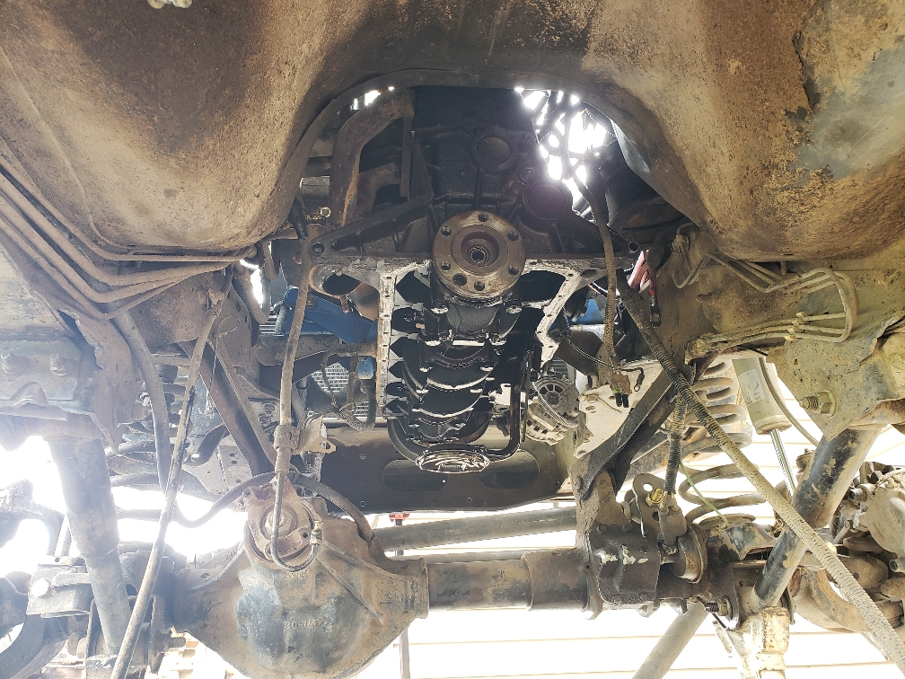

Def do the rear main while you have the pan out... Cheap and have to drop the pan to get to it- and likely to leak one day if its not now
In hindsight I see I sound like captain obvious there... but didn’t see you mention it, and who knows who references it down the line... google pulls some crazy stuff out of the air some times... so for the next guy
I actually wasn't going to do it. For Rcp shake I figured I better do it right. I dont want to get kicked out of the club ;)

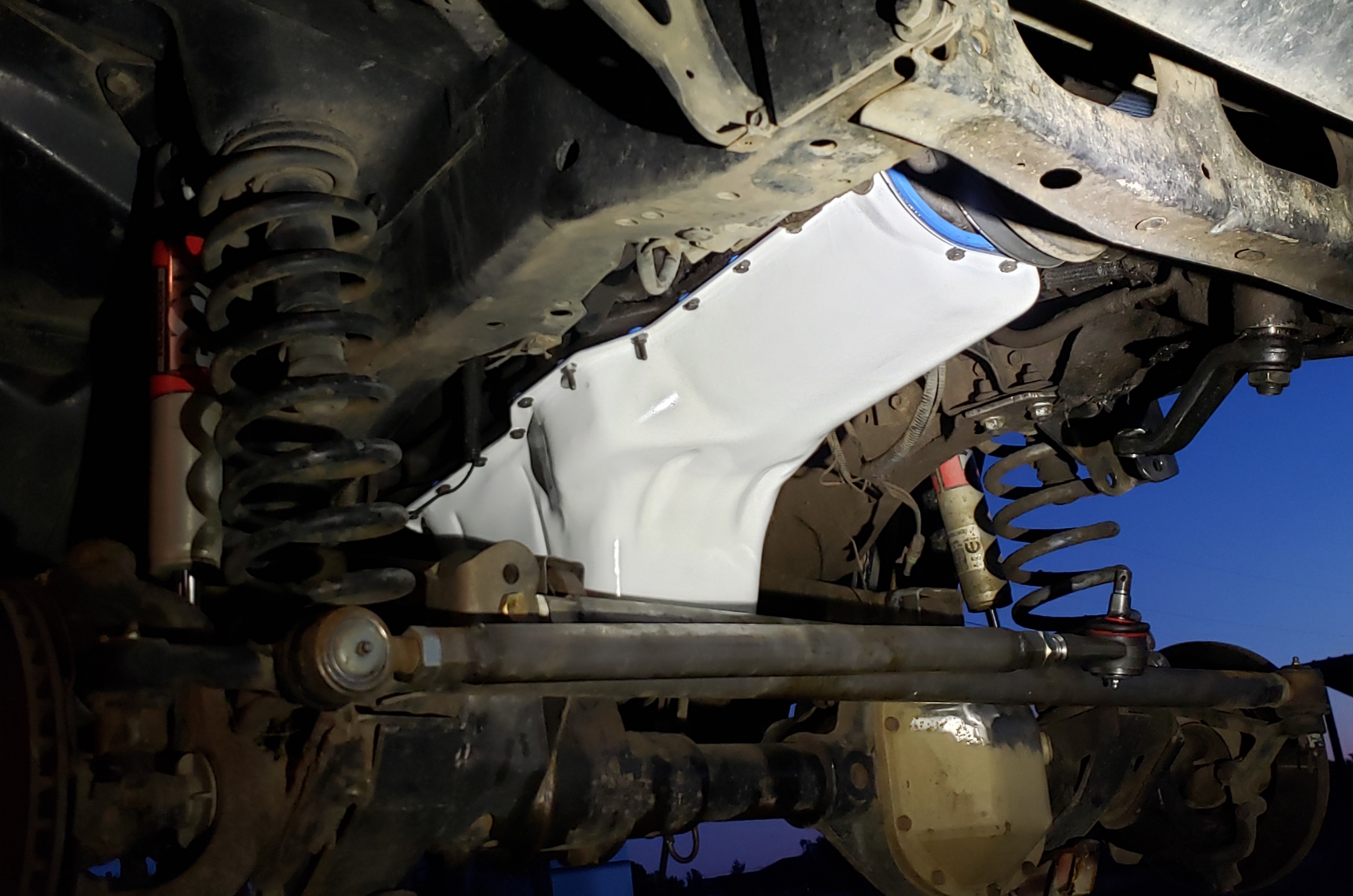

So I cleaned and prepped sprayed the pan Miller welder blue. Then cleared it today. Uggggh guess I'll do it over.
Clear is eating it off
what clear did you use?
all is not lost if you let it fully cure and sand down the high spots, or you could hit it with another color from an angle, then sand it to get some neat two tone look.
Cheap stuff. Rustoleum or something maybe the blue is krylon. I guess the dont go well together.
It does seem to be hardening now
Nice and purty.
That should show the oil leaks really well. (Knowing how Jeeps work)
Ohhhyeah.

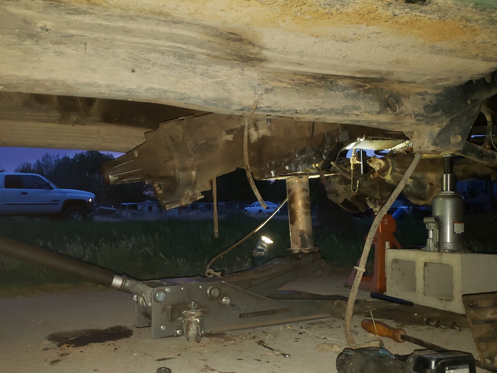

Did manage to get flywheel bolted on bolts cleaned and locktighted with red. I tourqed to 90 since I decided to reuse the old ones.
I'm debating on going out right now and bolting clutch on and stuffing tranny. Kinda thinking i might bolt tcase to tranny and stuff them together. The tcase shift lever pivot point bracket bolt is a pain to get to while in there.

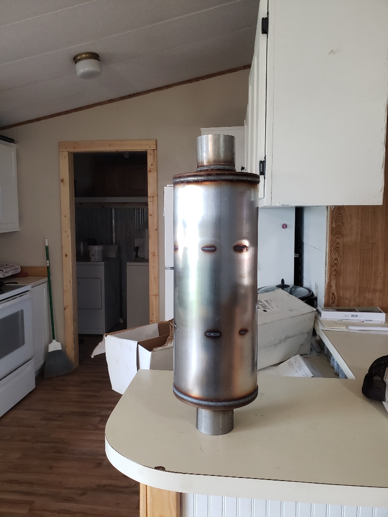

There may be random photo of magnaflow xl muffler in here. More on that later maybe
