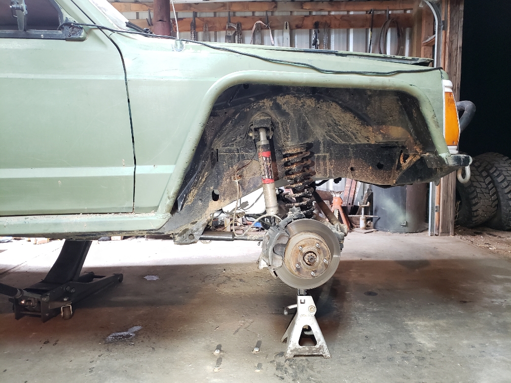

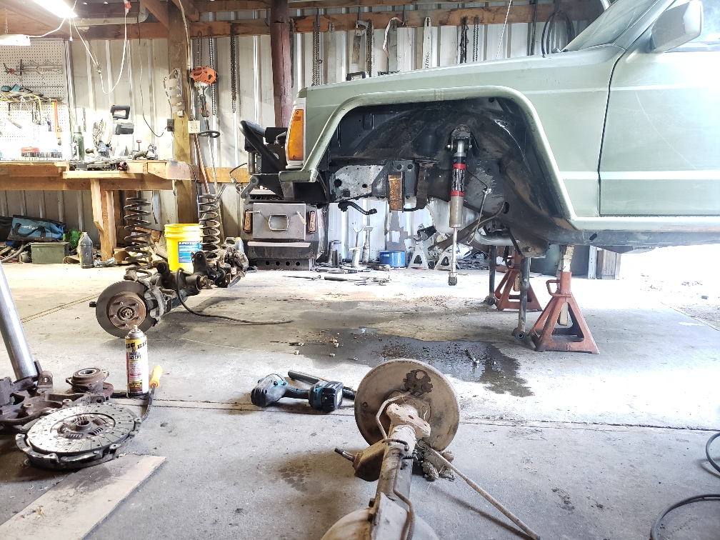

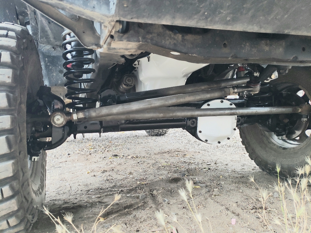

Just got home and decided to hang the housing before putting everything on it. Glad I did as pictured is 16deg castor 🤯
Luckily I also learned these arms are adjustable
Nap time then play with arms t get rid of 10deg or so maybe 12.
The arm is sitting how I had it pictured in my head. flaat
Shock mount straddling arm bolt. Man that arm is offset more than I thought. That's actually good for when I do long arms.

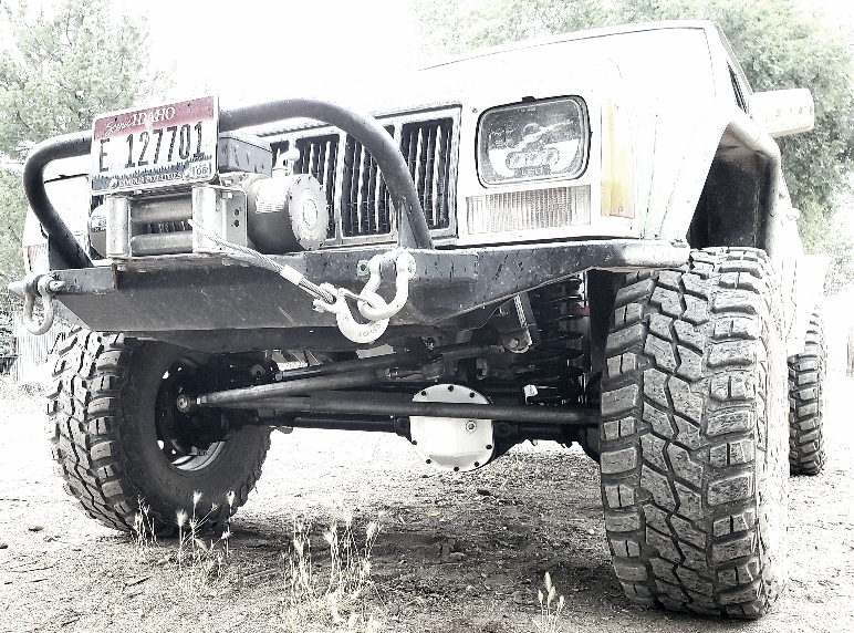

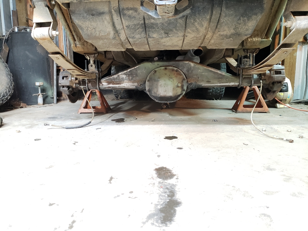

You said you were on like 3 inches of lift... But from the original location and stock shackles Id say thats a solid 5 inches, no?

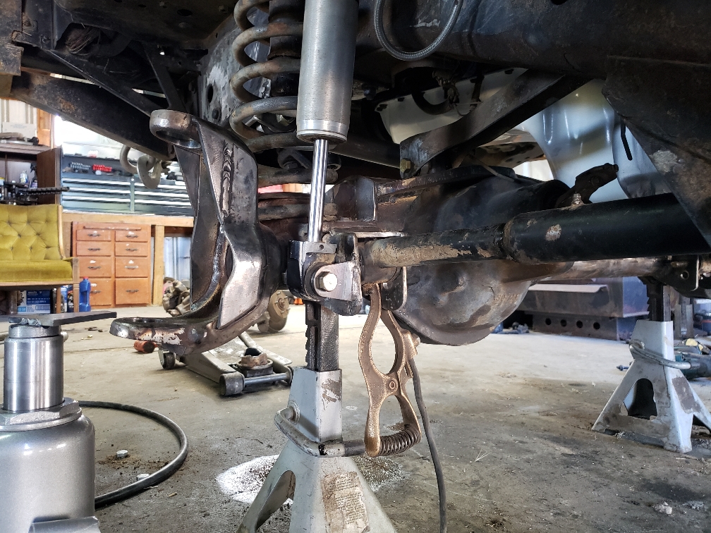

This morning I set toe. Reset it it. Was toed out for some reason.
Thought I had 4deg castor but I must be wrong or gauge reading a few deg of.
Will bump a couple more deg into or until coil runs into my track bar bracket.. drives like its has very little positive castor

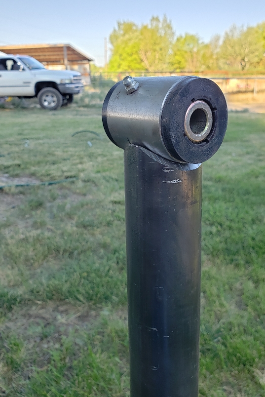

Arms will be 28-30"ish in not sure how long upper will be20-30" possibly 70% of lowers. But probably about the same for ease of fab mounting upper and lower on the same plate.
Have a bone stock xj at the house to compare I'm definitely 2" or less of lift.

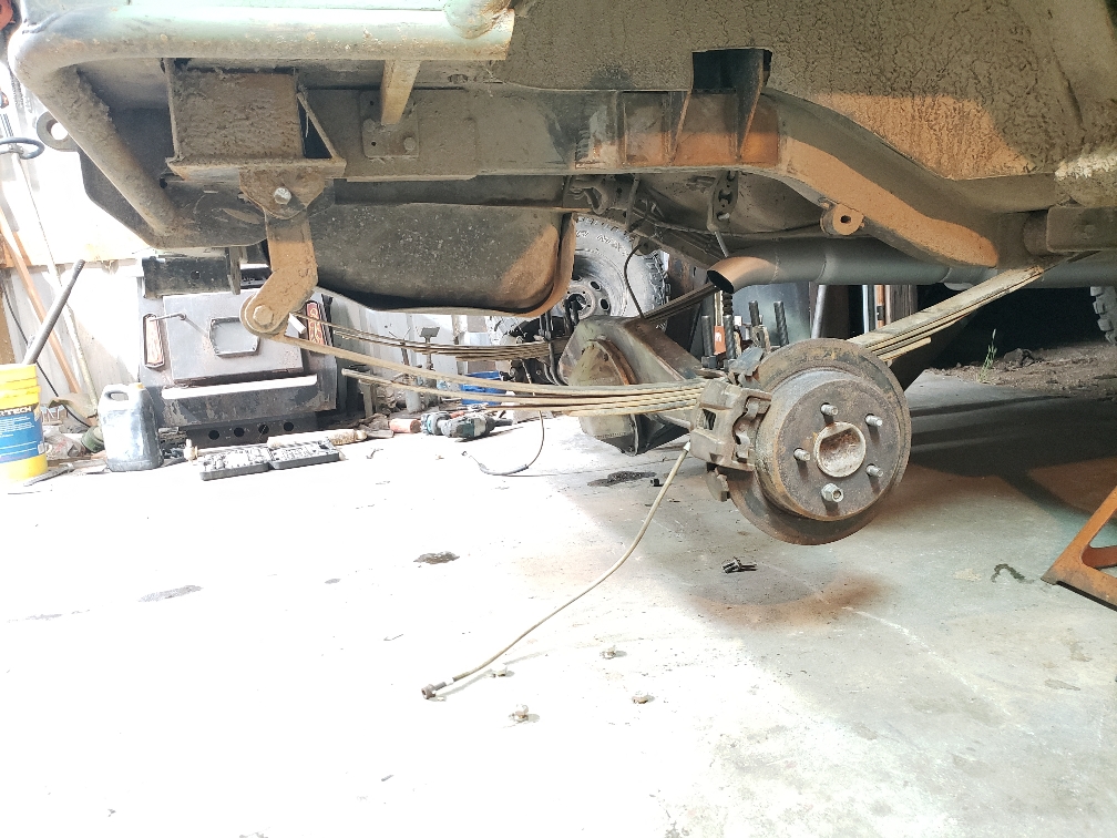

Yes shackle is relocated shackle length is 6" not quite at 45 leaf springs flat to slight negative arch at ride height

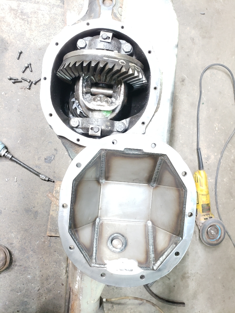

I love the welded rear. It's the 3rd axle I've welded and survived.

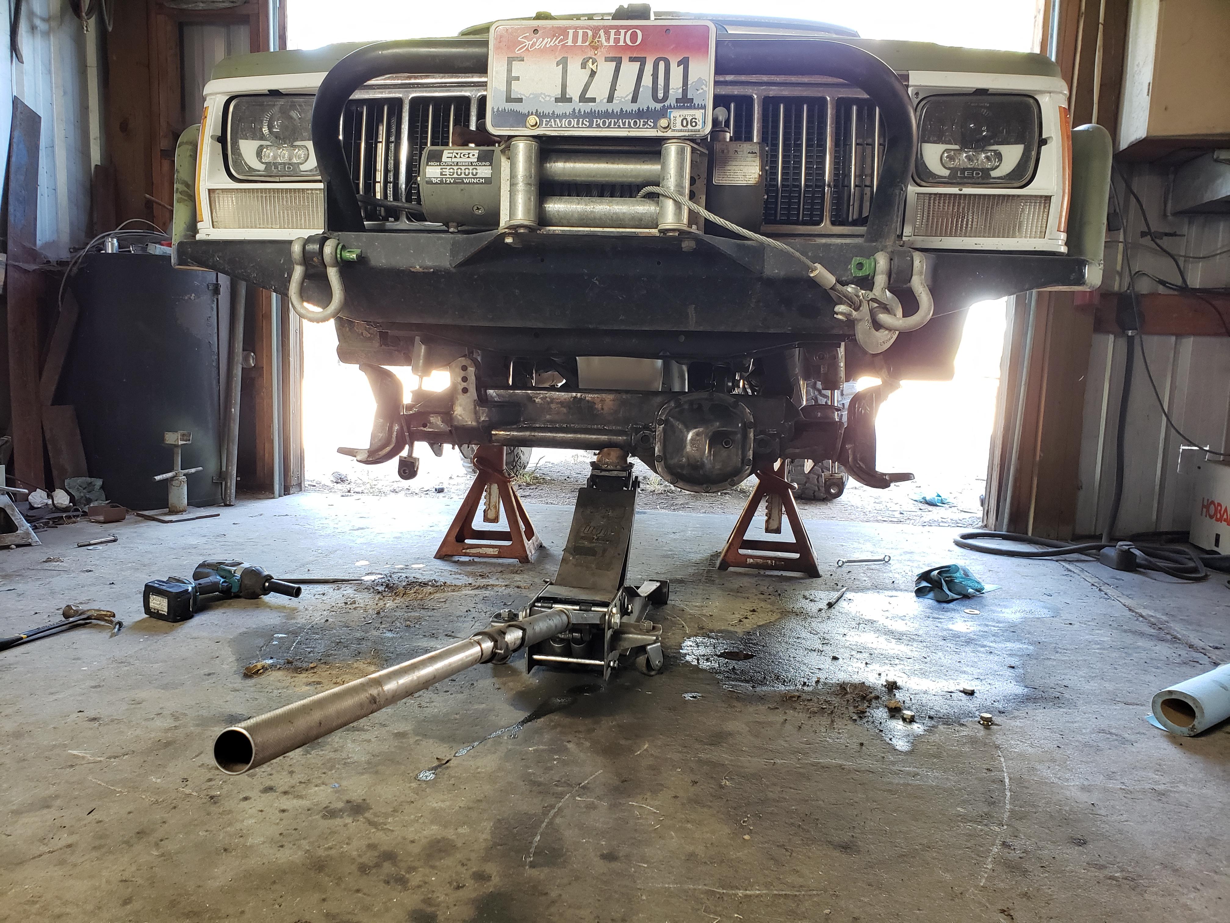

Picture on jack stands was this morning resetting toe.
Will get a few more deg castor and go out this evening. Hopefully that gets her tracking straight.
Lower arms arent quite as flat as pictured there offset 1/2"-3/4" on the axle side. I guess they're after market arms.

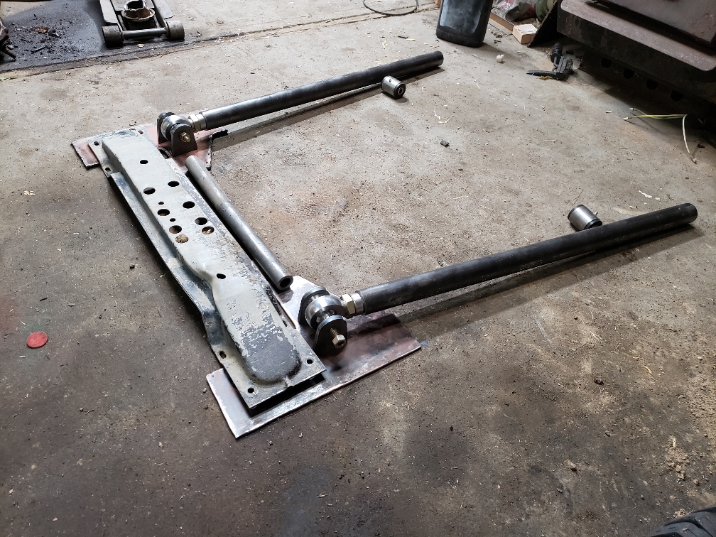

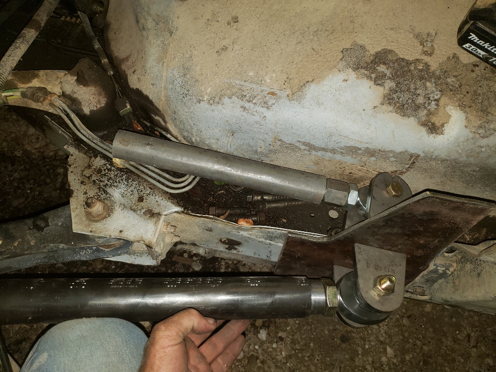

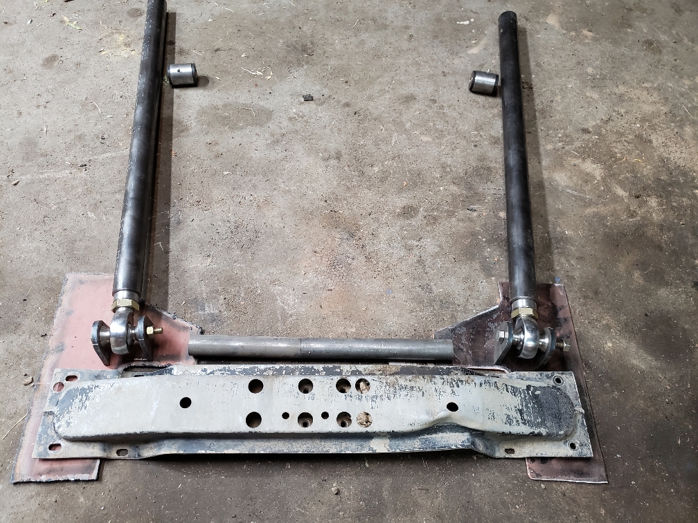

Scrounged some plate out of my stash since I'm pretty much out.
Roughed in plates . Poly bushing placed at about link length give or take alittle 28".
Brackets will weld to frame sides bottom and underside of unibody with some kind of crossmember bolted between them.
This project is under way because upper factory link will not work as a 3link and I want to get rid of some brake dive maybe not all.

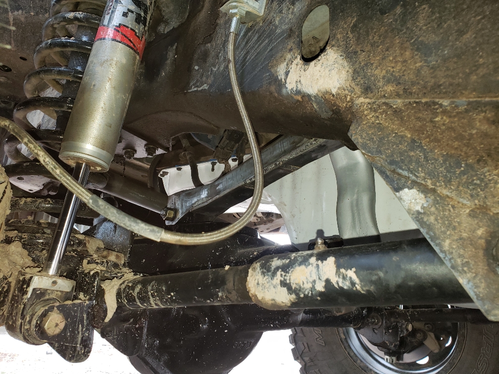

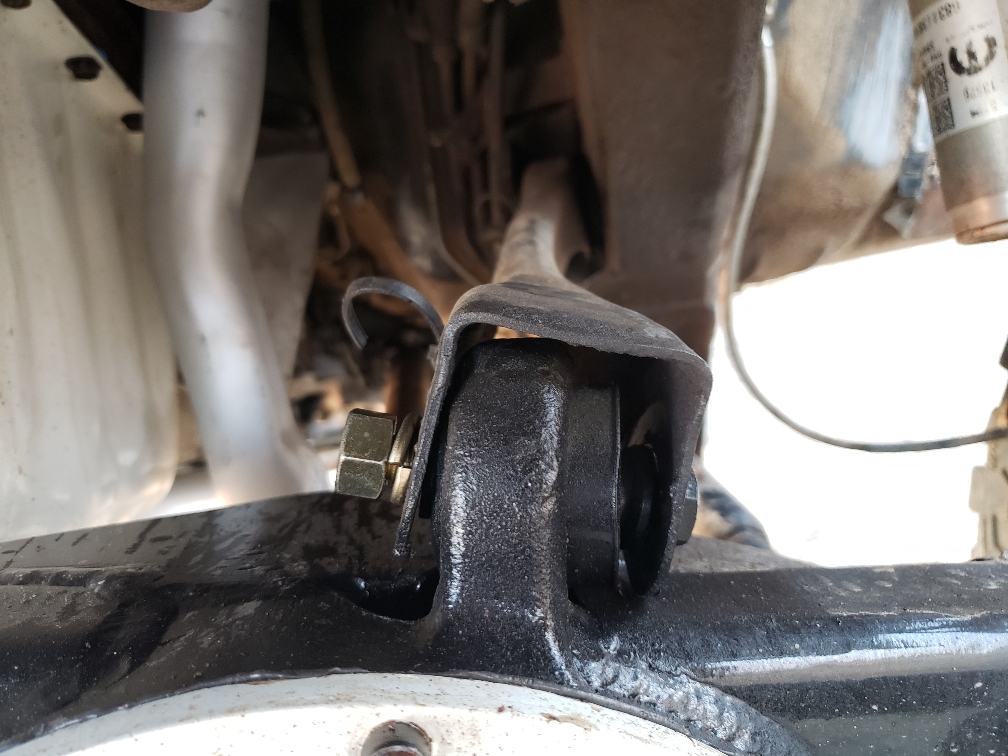

Heres the upper not being very happy
Yes someone forgot to tighten the bolt thankfully that some caught it and tightened it.

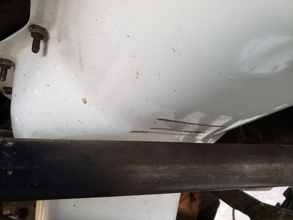

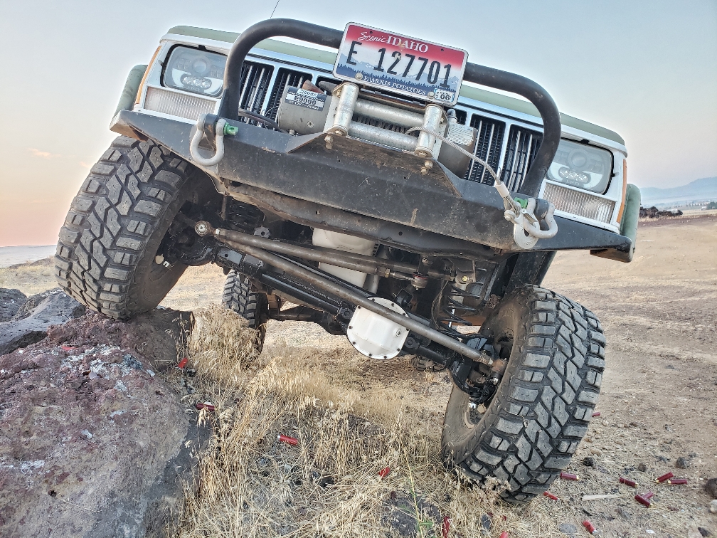

Getting alittle contact driving at speed in the rough rolly stuff. Just barely touching

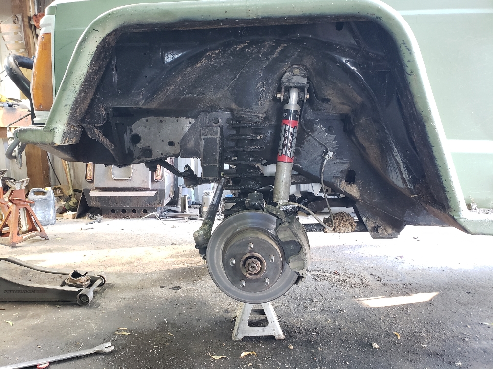

Thinking about going to a post top mount shock in 12" stroke to gain some travel. What I'm running is only 9" just aren't long enough.

Three links on short arms, one being factory is DEFINITELY not advisable. I thought you were doing passenger side 3 link? If so, throw the other factory arm on until you get the Mid arms complete.
Your shocks aren’t long enough?? Looks like they are to long to me... in the flex pic driver side isn’t showing 9”s of extension is it?? Looks like they are to long in all the pics to me
Yes 3rd passenger is the plan. Its tight probably have to beat the floor in to maintain some link separation.
I welded scrap on factory upper so I can drive it for now.
Yes shock is limiting factory both ways

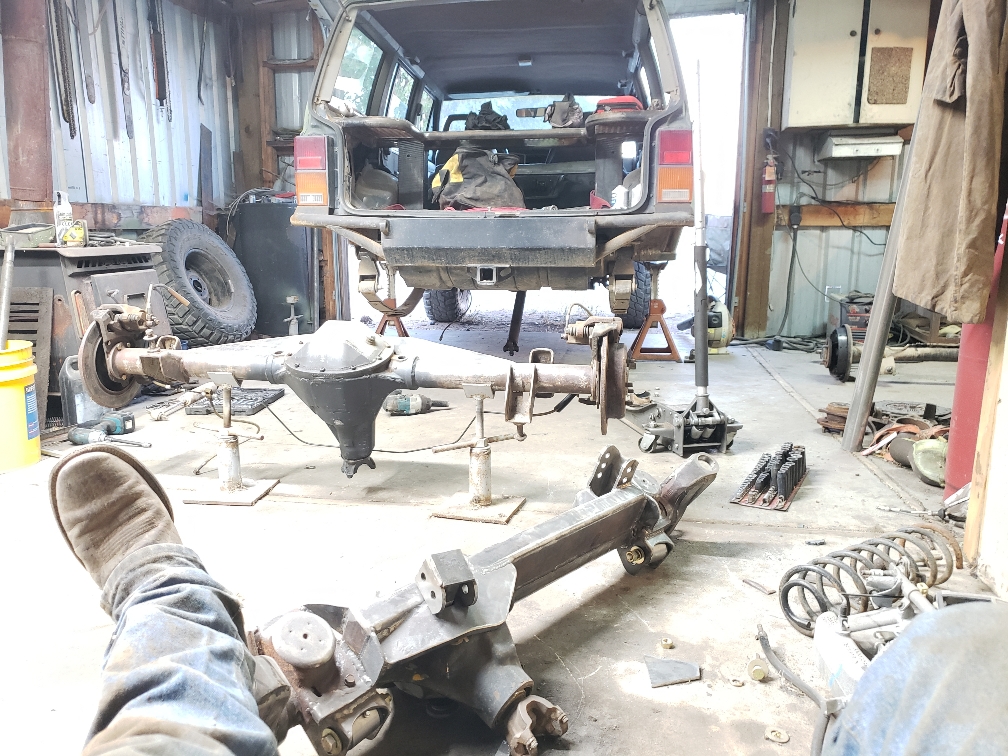

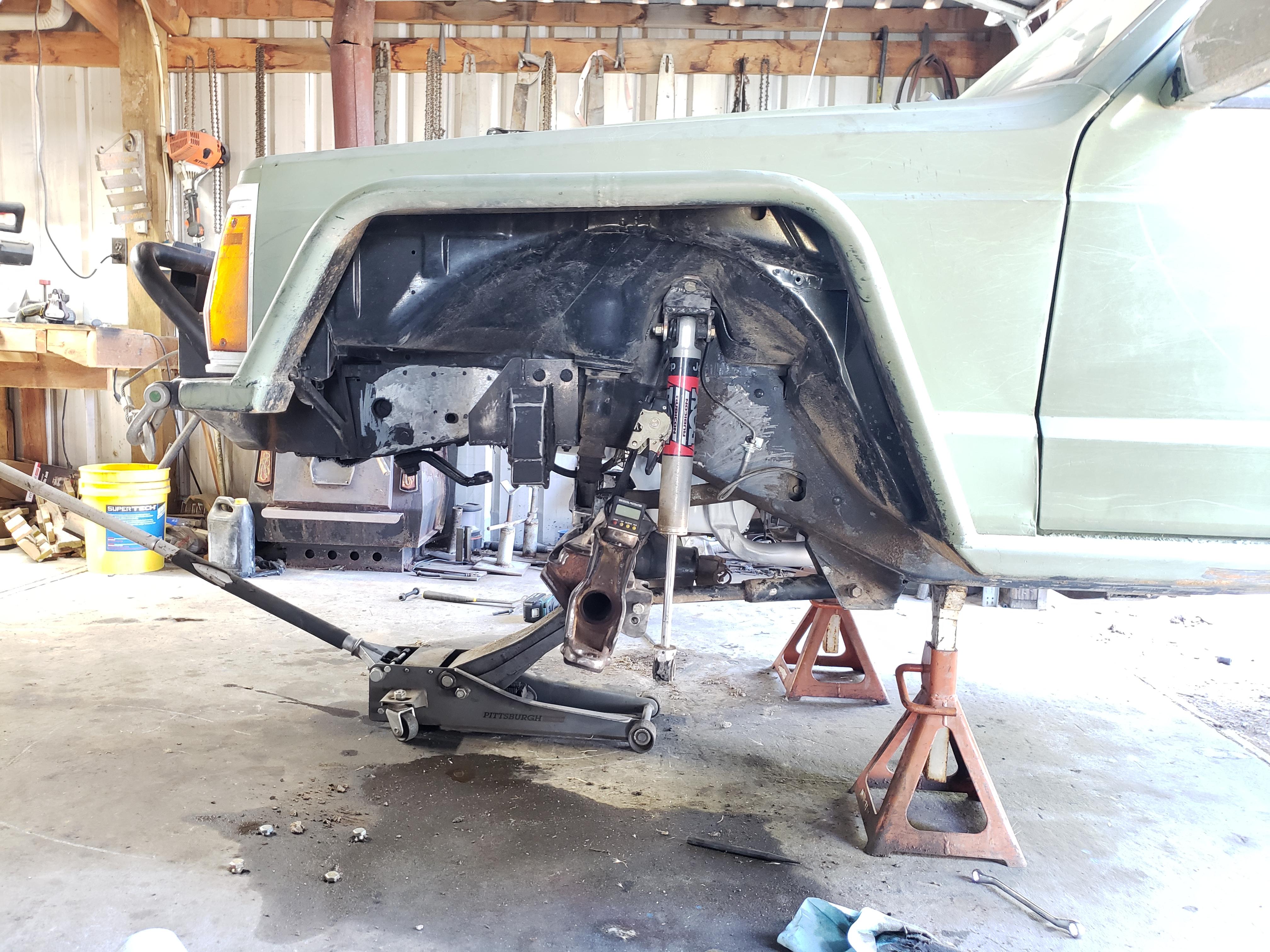

Moving link mounts to jeep from mock up jeep .
