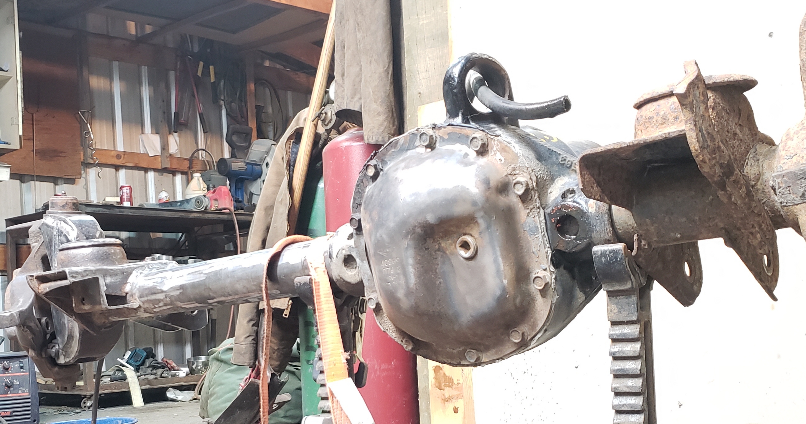

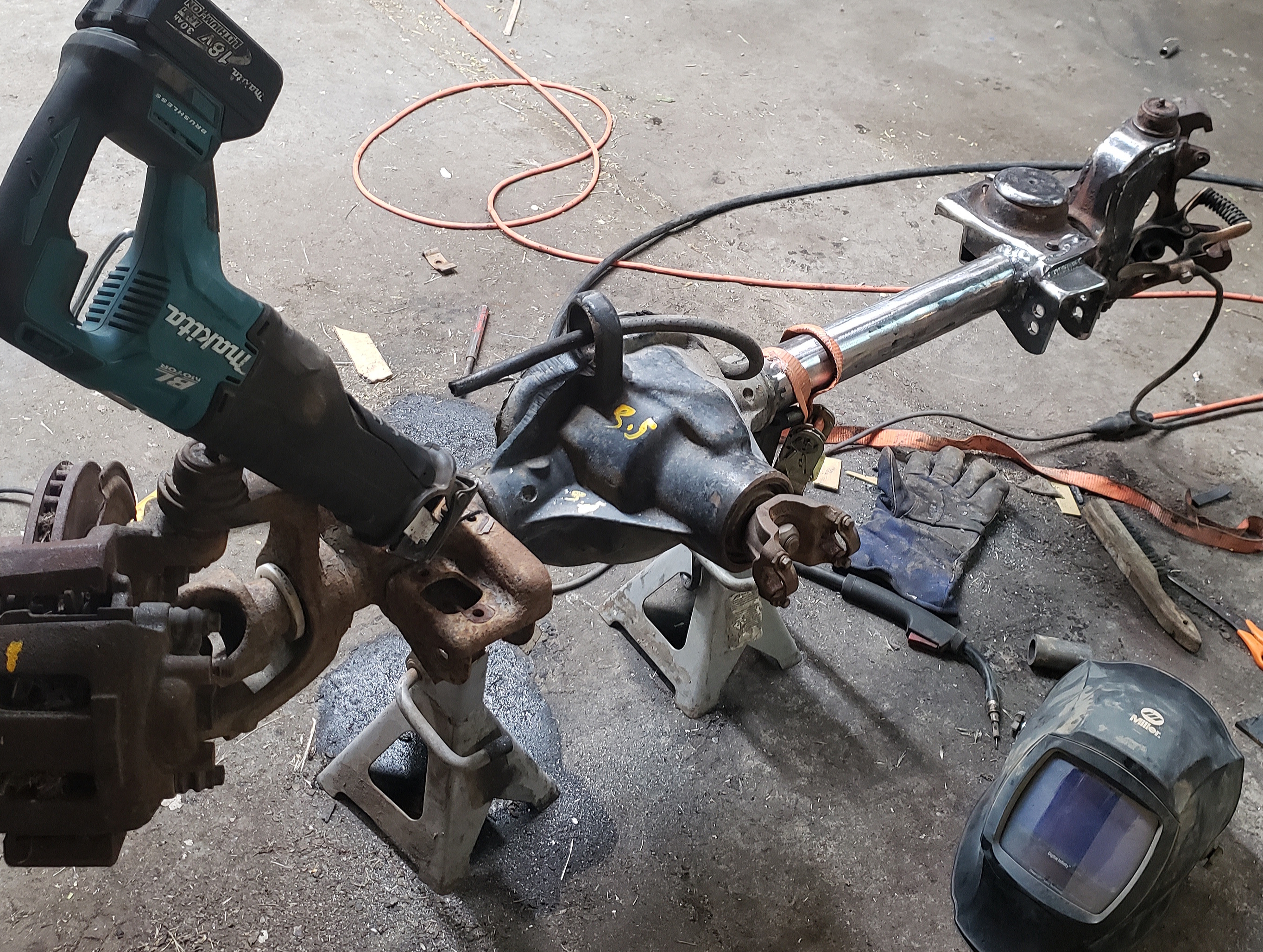

Tonight I didnt do much. Added alittle more C material while I thought about cutting the upper control arm mount off.
Then I did it.

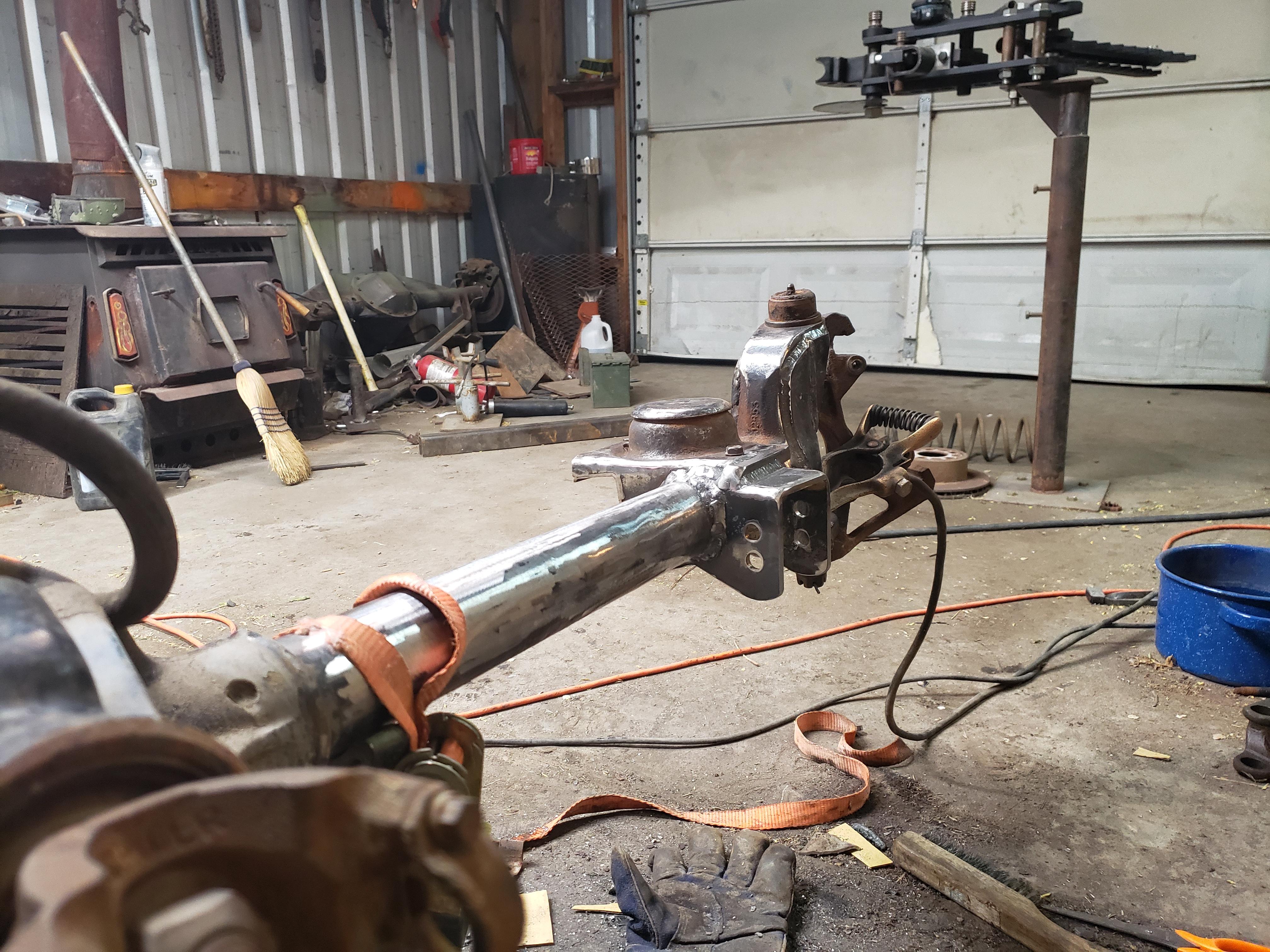

I may attempt to run a short arm 3 link will be a good idea to beef up the upper control arm frame side if I do.
Probably going to also order artec lower control arm brackets.
If lower brackets were in decent shape I could box them with 1/4" but there all shitty.
Kinda in the going no where stage with this axle only progress is c gussets on one c and those almost seem pointless.
Though I am starting to see a truss in my head and a way to remount passenger upper arm with heims on both ends.
Probably getting bored with my updates with no progress to speak of.
If you are gonna run a 3 link, I’d recommend just doing it right and making either long arms or at least mid arms. Just my opinion of course

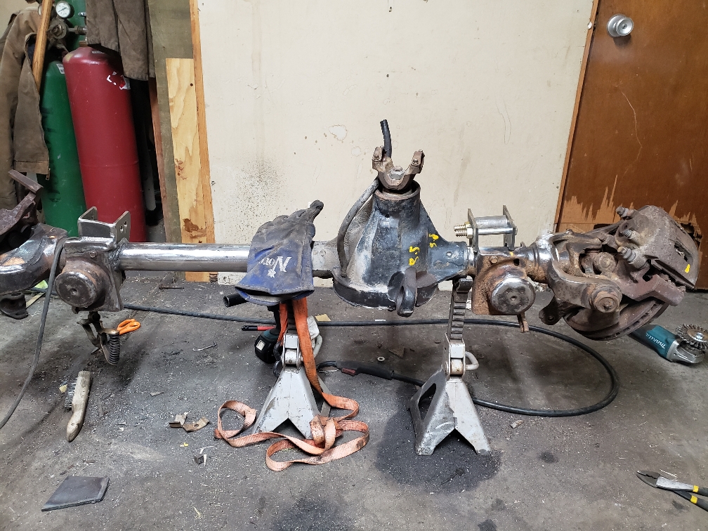

are you burning on gussets and running the ball joints?
Ball joints are toast if he got ANY decent penetration... Even if they dont physically smoke and fall apart,100% change them after C gussets
Ball joints will be changed. Was glad to be able to put caliper on to make sure it clears. It just does , I think hope.
Everything on this axle is junk and rusty. I'm scared to take the cover off though some decent looking oil came out the breather.
Balljoints were smoking a fair amount.
I'm not sure what I'm doing. I guess I cut the upper munt off so I have to do something now.
The upper mount isnt impossible to replace with an aftermarket unit... Or truss with it incorporated. So you arent forced into 3 link. Although with your fab skills and readily available tools... Might as well make it worth it?

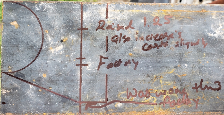

Efforts are going into lower control arm mounts will be raising mount slightly. Decided I can build lowers .
One lower I feel is unsalvageable need hacked off and redone.
Artec appears to be the best direct replacement but would be nearly 100 bucks after shipping.
I'll raise mounting point 1.5"ish. To bring links parrel this also puts lower link damn near like it was at factory ride height.
Not entirely sure why factory set axle separation at 8.5" on axle end and 7" at frame end. Maybe to make it more stable cornering on the street. ? Or does it have to do more with angle change during suspension arc being upper are shorter than lowers.
Most long arm kits barely get 5" separation on frame side some almost no separation.
8.5 to zero separation. Weird but much easier to push 1200 kits out that way and also gets upper link clearing components.

Just measured angle on upper and lower links.angle finder says lower is 4deg steeper than upper tape says that's about 1.5" difference.
Only problem I see is that puts link bolt where my shock bracket wants to be. Hmmm

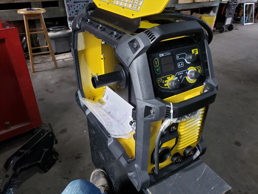

If we get another stimulus check and I fall in love with the 235 I may order one for my garage.
Welder isn't mine though I pushed for it. Its freind of mine I do some welding for.
I may burn suspension links with it ounce I dial into the machine

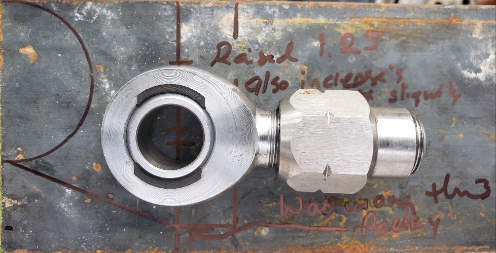

Build upper control arm reinforce upper mount drill to 9/16 for 7/8" heim

Longer arms. Possibly redo passenger side mount. After trying 3 link for while
Hoping the 2nd stimulus check comes to help with the bigger stuff like clutch and 1.25 heims.
