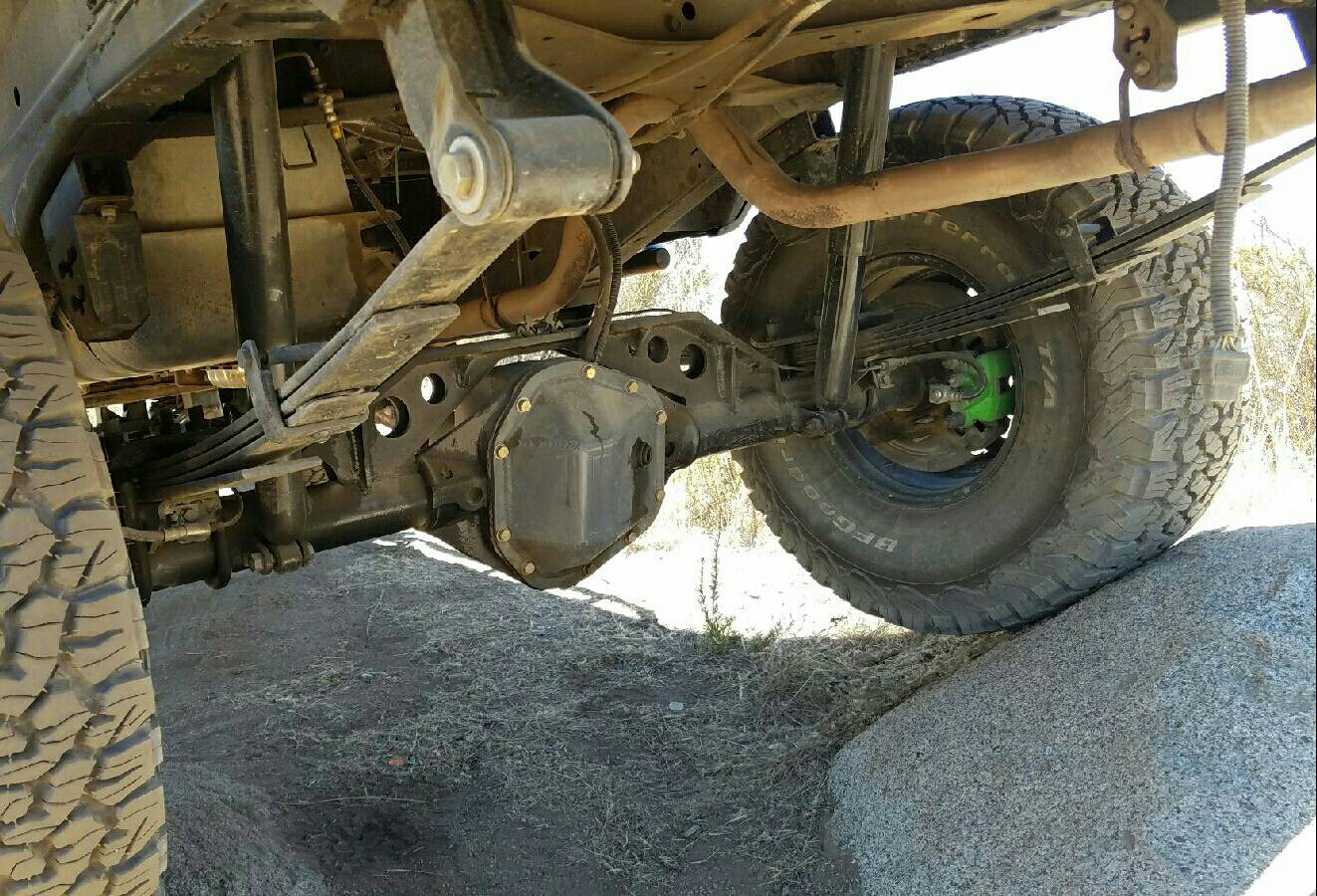

I run 97-03 f150 spring packs and RE boomerang shackles. They're slightly longer 2/1 packs and I added an Mj 3rd leaf I had lying around. The ride is a little more firm than I like, but my shackle angle isn't perfect and I'm also running poly bushings (only replacement available). Eventually I would like to have some Deaver or Atlas springs built. Here are some pics of the setup, the truck is on 35s--
There's really not many negatives to being soa on a DD or trail rig. Going spring over with the dodge springs should net about 3" lift....don't forget the dodge spring is flatter than a stock mj spring....you won't be too tall I think.
Fyi, my dodge springs sit flatter than the ford springs pictured above
I did a little research on the 94-01 Dodge springs and they definitely got my attention. My f150 springs only cost me 40 bucks but I had to make some steel sleeves for the front bushing because ford uses a larger bolt there. The Dodge springs look to be 9/16 front and rear. I like the extra length and it would help with my shackle angle, but I don't really want to stretch the wheelbase any.
