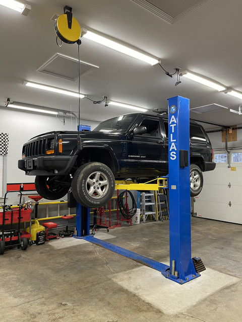

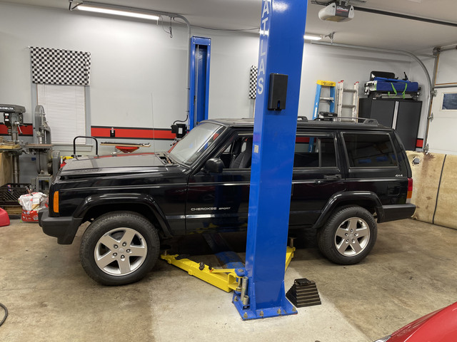

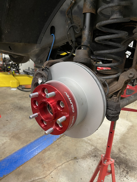

Just to follow up on this, I ended up with 1.5” hub centric spacers. I installed them and mounted my freebie 225 tires on them. Ended up with a little more poke than stock, but that’s ok, I’ll need the extra space when I lift/get wider tires eventually. This also required new longer wheel studs.
Before/during/after.
