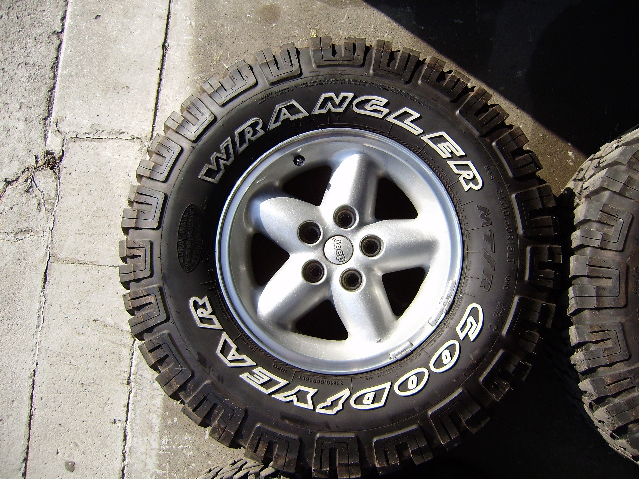

Owner claims it came off a TJ, any ideas what it's called, size, backspacing etc? I am guessing it's a 15x7, but no idea what back spacing might be. Am thinking these would work well on an XJ.

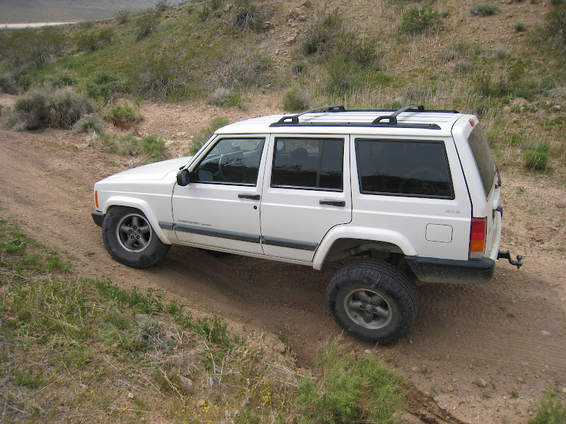

That's the Jeep "Ecco" wheel. They came on my '99 Cherokee Classic. One of my favorite wheels but sadly I replaced them because I needed a wheel with less backspacing. They are 15x7 with 5.25" backspacing. Mine were a darker color, but here's how they fit on an XJ with 33x10.5's:
So 5"25 backspacing with 31's will be ok on an XJ with a 3.5 Lift? I guess it would work since Moabs are 5", another .25" shouldn't make much of a difference.
Here is what they look like with 31x10.5x15 tires on a 1999. They stuff very well. I still have the plastic liners inside the fenders and the tires are rubbing those. I think I need another 1/2" of bumpstop.
