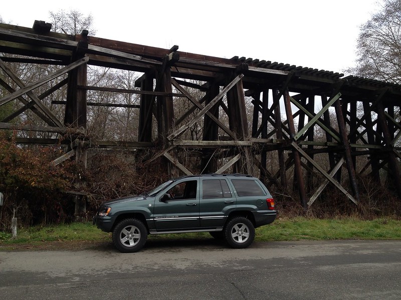

I now DD the overland my dad bought. He doesn't like the color as much as the metallic grey, so when he has to buy a vehicle, (retirement= no more company car) he will buy a grey overland.
So I've been building my overland now.
3 inch IRO lift, jk rubi wheels/tires. Love it. Quadradrive is unreal for a stock 4x4. Amazing.

Even with the 32's and high output, fuel mileage is at least 4 mpg better on average than my cherokee. Hence the DD duty.
