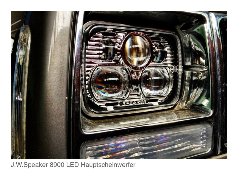

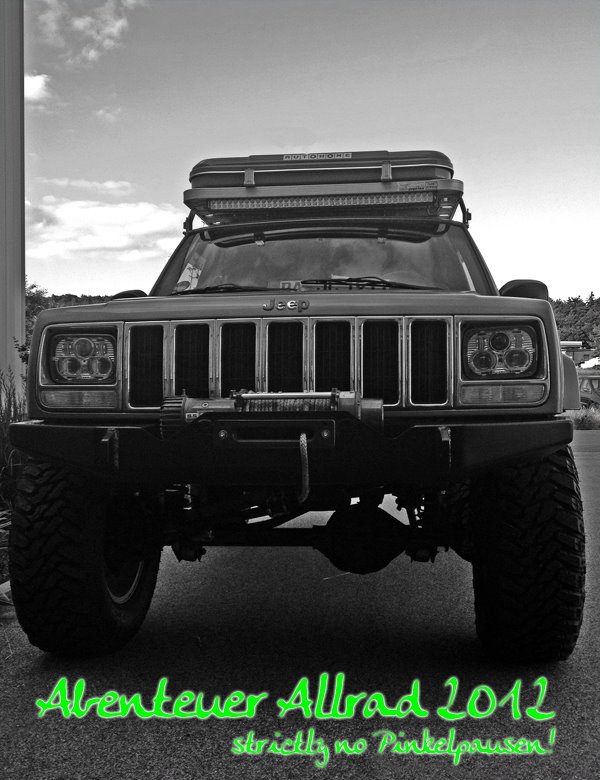

Offroad light duties are handled by a 78x 5W LED bar from Vision-X (38000+ lumen),
a set of street legal (means: E-coded) driving lights (9x 5W each, EPX-910 from Vision-X)
will be added later today, two small 2x 10W LEDs will light up the area before the winch
and 4 Solstice Prime 10W work lights live below the roof rack for lighting the camp at night.
Two more Solstice 10W live recessed in the rear bumper.

WOW, $1200 for the set! There is definitely other options.
Love these lights but there is just no way I can justify $1200 for a set of headlights...
Now if that included upgraded wiring for the entire rig, new high output alternator, new Optima Batter, etc... I might consider it.
... and I thought my Cibie lights were expensive... :)
Well, lets see here... I paid $2500 for the entire Heep around three years ago. So....... add in a 48% of initial cost for a pair of headlights. Sure, right. Well, OK, maybe not.
