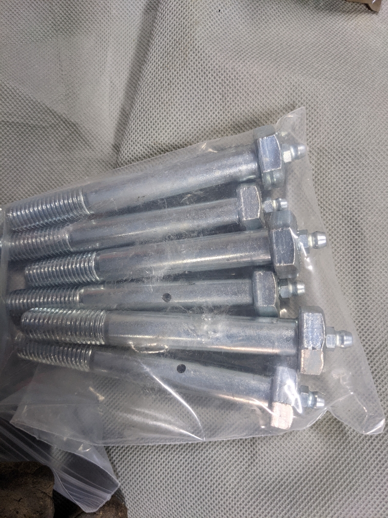

Then he called me back, suggesting 9/16" that they have in stock and will fit the slots, but I reminded him the thread pitch is not correct for the captured nuts inside the 'frame' so that's no go.. too easy. Correct me if I'm wrong.
I just checked - A 9/16-12 bolt will not thread into a M14-2.0 nut. Based on thread dimensions, I thought I might get a few threads of engagement, but instead it bound immediately.
With that said, its no problem to source M14-2.0 bolts of a variety of lengths and grades. The grade 10.9 M14-2.0 bolts for my shackle relocate were purchased from Fastenal.
Yup, exactly what Mike told me about 9/16" vs. M14. And he also sources bolts from Fastenal. Just that MORE will do the CNC, etc.
Got'em. M14 x 2.0 x 110mm. Waiting on the springs.
