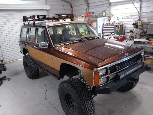

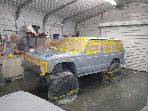

In April I decided Gonzo needed some new paint. Clear coat was shot and I had it plastidipped brown. The plastidip turned green in the desert sun, and it's 90 minutes to next big town to get more. I sanded it down, and started shopping for supplies. I ended up using SPI epoxy primer, fixed all the dents, used SPI build primer, and painted with Urekem root beer pearl. We painted my wife's car hot pink pearl about 8 years ago with the same stuff and it's held up great, so I felt comfortable using it again. It turned out pretty good. I still need to do more cut and buffing, but it's pretty good right now.

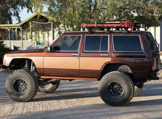

I put new vinyl on it. I think I'm going to put the vinyl on the rocker guards too. I repainted the roof rack and the high lift and shovel. Not shown in the pics, but I reinforced the roof rack and made a spare tire holder that tightens down with some big ole wing nuts that I safety wired to keep from backing off. I cleaned the interior and got new seat covers for the seats I got from Jon a few years ago. I got some wood grain vinyl fabric that I attached to the seat back and am using as a cargo cover. I also did the window tint myself. 5% in back and 20% up front. Turned out pretty good with some minor imperfections. I used Global window films, which is the highest rated film that sells rolls to consumers. You have to buy a whole roll, but it won't fade in a year like the Amazon and ebay stuff.
