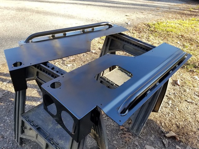

JCR quarterpanel guards with rub rails and light boxes. Tired of breaking tail lights, tired of beating the quarterpanels, tired of breaking cargo glass. Ordered these on Black Friday over the phone but had some trouble getting them, then had some other delays, and just got them installed this weekend

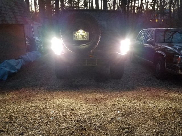

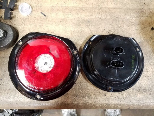

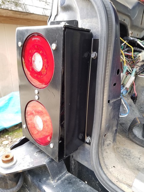

I chose to use the Optronics GloLight 3-way LEDs. These have an outer ring that I ran to the running lights, an inner cluster of red LEDs that I ran to the brake light (top) and turn signal (bottom), and a center white cluster for reverse. The red rings look great at night, and the whites are very bright and 4 of them give a ton of reverse lighting.
The light boxes are designed to use flanged LEDs from the inside, but the boxes are too small for the flanges, so I had to trim the edge off the lights before I could install them.
They fit pretty well against the Dirtbound lower quarterpanel guards. I had to drill new holes in the JCR panels for the Napier flares, but they sit together nicely. Very pleased with the way they came out, for the most part.
The biggest complaint I have is that the boxes themselves do not fit plumb, and are kind of crooked against the hatch. As a result the inner box plates have a bit of a gap that gets larger at the bottom.
Its not horrible, but it could have been resolved with another little 1" fold and having the inner box plates pull it all together tight. Also not happy about having to void my LED warranty by chopping the required flange. Typical JCR, high production quality cannot make up for weak design.
Overall very pleased, could be happier. If I were doing it again I would probably look for something with metal tube flares and do that instead of the JCR+Napier combo

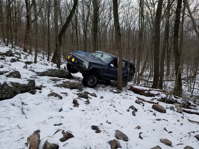

Did some wheeling at AOAA last weekend. Pretty tough trails in good weather, murder with ice on everything

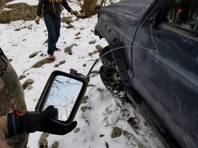

A little damage... still drove it home
