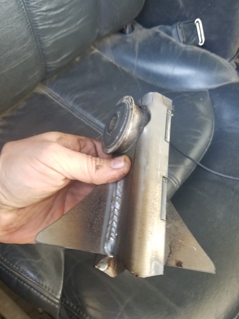

I also discovered that my passenger UCA bracket was mangled up and replaced it. I had crushed it up sometime in August, then it broke off from the axle entirely at the Fall Crawl. I welded it back on, but it broke off again at Uwharrie. I called Undercover Fab and they had one in stock and were willing to ship quickly, so I bought it and got that installed today. Nice piece, solid, easy to install.

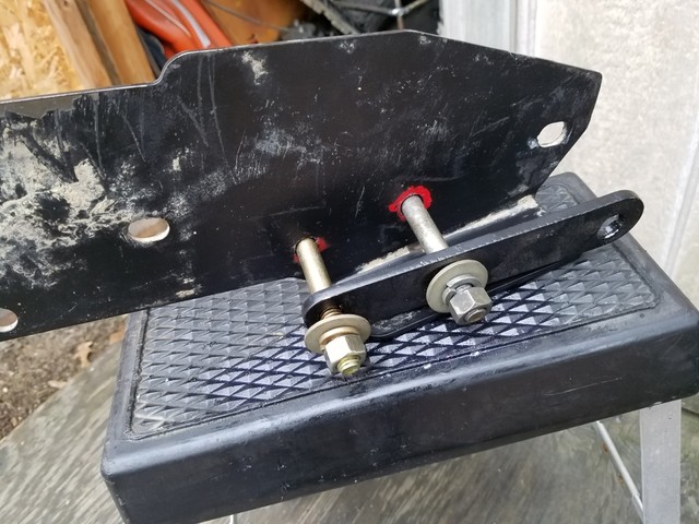

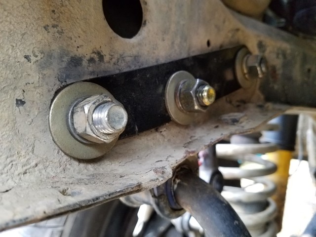

My old Hi-Country tow hooks had three bolts through the passenger frame rail, mirroring the three holes for the steering box on the driver side. The JCR bumper tie-in brackets only have one hole on the passenger side (not counting the two swaybar bracket bolts). Even though the other holes aren't sleeved or anything, they did increase load distribution (single shear to triple shear), and I already had holes in the frame rail, so I duplicated the bolt pattern
The basic setup just uses a strip of 3/16 steel that braces the inside of the rail, with matching holes in the tie-in bracket on the outside. For the inside strip I just copied the Hi-Country bracket while I still had it (sold it a while ago). Then for the other holes I sprayed paint through the existing holes in the frame rail to mark their general vicinity, overlaid the inner bracket, and drilled the outers to match

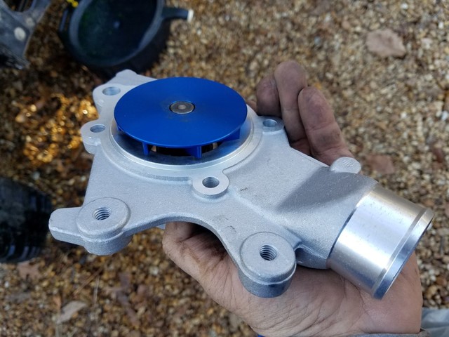

Haven't had any real problems with engine temperatures after getting the exhaust repaired, but one thing that always bugged me is that the whole coolant system kind of struggles when sitting at a stop (whether waiting on the trail or sitting at a red light). Highway cruise temperatures are about 200F but sitting at a stop the temps will climb to 215-220F because there's less cold coolant GPM for engine heat to transfer onto. Meanwhile the heat stops working as well in winter, since less hot coolant GPM flowing through the heater core for the cold air to blow across. I figured if the front end is off its a good time to swap the water pump, so I bought a FlowKooler 1747 water pump with higher flow at low RPMs, should give lower engine temperatures at stop / idle / crawl, and also give better heat in winter in the same situations.
I had installed a new pump from NAPA when I swapped engines a few years ago, and it still looks and feels good, so I'm going to put it in the expedition bag as a spare.
