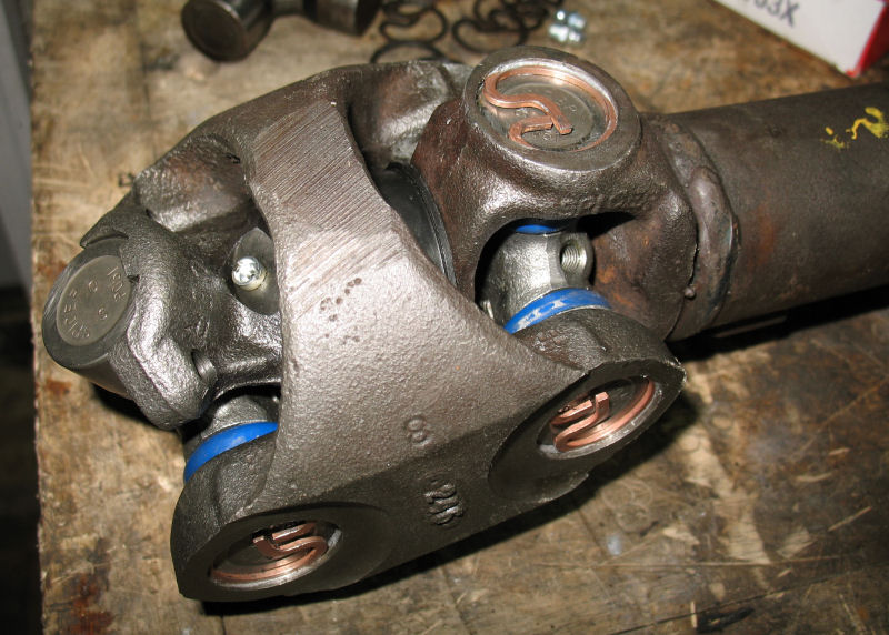

Got some extra coins so did some work to get the beater a little smoother and quieter. First was to replace the rear u-joints and reinstall the YJ slip yoke. I was afraid it would be too long with the 8.25 driveshaft (on my D35 yoke) but it sets up fine and the ride is much much smoother. There is still a hair bit of vibes when I reverse quickly, which is due to the pinion turning down I suppose. Not much to worry about (I don't do much racing in reverse) and not much that can be done about it so whatever.
After that I replaced the u-joints and centering ball on the front driveshaft too. I thought they were probably originals but after I got the parts cleaned up I found junkyard paint marker on it, so I guess it's something else that my brother broke. The front parts were pretty nasty and one of the joints had a broken spacer ring in the cap, but it all cleaned up well. The new centering ball is greasable too, which is another plus. I need to find low-profile needle fittings to use instead of the zerks that came with the u-joints but for now it's installed and working, and the jeep got smoother and quieter again.

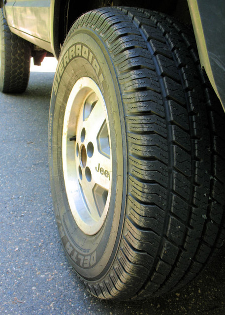

Also got two new tires for the front to replace the cupped and cracking BFG ATs. I had planned to run the used ones until I got the axles swapped but the economy isn't improving quickly enough for that so I had to do something. I looked for two more Dunlop Radial Rover RVs to match the ones in the rear that are still good, but the RV is discontinued and the replacement models don't have the same tread pattern. Looking around I found the Goodyear Wranger GS-A was almost identical (Goodyear maybe owns Dunlop?) but it was also discontinued. I was going to punt and get a couple of Grabber AT2 (I loved the Grabber AW set I had before) but found these Delta Sierradial AT locally which is a Cooper knock-off like the Definity tires that Pep Boys sells. The tires are soft and feel good on the road so far, and $300 even for the pair of them installed so that's a pretty good deal if they don't explode on the highway. Anyway ride is smoother and quieter once more so it's an improvement.

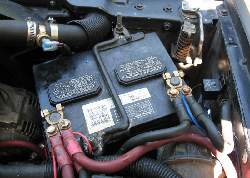

More problems with the electric fan setup. When I'd left off on that, I had a variable temperature switch with a probe that was inside the upper radiator hose. This gave me really good control over the temperature, and I was able to lock it in to exactly where I wanted it to come on and go off, so from that perspective it worked great.
However there are also a few problems with the setup. Most significantly, the probe wire makes it really hard to get a solid seal on the radiator hose at the neck. The stock constant tension clamp would drip and steam, so I replaced it with a worm clamp and it did the same thing. Then I doubled the clamps and that worked but eventually one of them would come loose and I'd find a puddle of coolant under the front-end. I also had problems with the dial on the "controller" moving itself due to engine vibration, and so I periodically had to move the dial back where I wanted it, but this was minor compared to the potentially fatal leaking.
Now that I know the overall setup works, I am trying to find a simple on-off switch that can be used instead of the adjustable controller. My intention is to try and use the block drain plug for this since it's tapped for 3/8 NPT already, but I may eventually move to using one of the heater hose adapters if I can't get this working reliably.

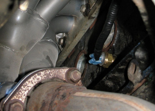

The first candidate is the Painless 30110 fan switch, which is listed at 200 on/180 off. It's 3/8 NPT and includes a 1/2 NPT adapter that I don't need. Summit got it here for slightly less than $50 after shipping. Here's a pic of the thing installed--the hardest part about this is routing the wires so that they don't get to close to the exhaust headers.
Test drive shows that it first comes on at the right point (about 215 on the gauge), but then stays on forever after that. My guess is that the block changes temperature very slowly, which keeps the coolant temperature very stable down there, even though the coolant is coming from the cold side of the radiator. So I will probably need to move a switch to the heater hose to get a more responsive reading, unfortunately the temperature on this switch is going to be low for that and the fan will probably still stay on.
Supposedly the 81-82 Corvette fan switch is 215 on/195 off but it is discontinued (BTW, Standard owns everybody that makes switches). I may grab one of those in the discount bin for $10 just to try it. I don't think I'm going to be happy until I buy a SPAL controller and convert the whole system to that.

I got the Corvette switch from rockauto. Plugged it up and took it for a test drive... came on once, went off a couple of seconds later, and hasn't come on again since. Ahhh maybe the block is causing problems or wiring is perilously close to the exhaust so I broke down and moved the mount to the radiator hose.
I ended up buying a 4" piece of 1" brass pipe that is 1.25" OD, and then giving the local mechanic a couple of bucks to drill and tap for 3/8 NPT, total cost was about $25 and the pipe was half of that. Wiring is simplified, since everything is all right there (you can see the relay on the fender wall). I will pickup a couple of constant tension hose clamps at the junkyard next visit.
Tried the Corvette switch but it didn't come on here either. The switch is either broken or lazy. I can't find specs on the thing (Standard removes database entries when parts are disco), so I'm tossing it rather than trying another. I grabbed the Painless switch and it comes on about 205 and stays on, as expected. I have looked at almost every fan switch out there and the only candidate left is a 1-wire switch from the 1986 Buick Regal T-Type (the GNX) which comes on around 210 but 1-wire makes it hard. It looks like all the good switches are metric nowadays so I may get a set of taps and go with one of the 3-wire switches--1994 BMW 325i dual switch (NAPA), #1 on at 195 and #2 on at 205 would be perfect to wire up a secondary low-speed circuit on this fan.

In the meantime I've looked at other switch options and decided to get the two-pin switch for the 85ish to 95ish BMWs. Most of these use the 3-pin switch I mentioned earlier but there is apparently a 2-pin on/off version that is supposed to come on at 203F (95C) and go off at 194F (90C). Four Seasons part number is 36511, the one I bought from NAPA was ATM part number 1435033. It's a basic 2-pin switch like the others except it is 14mm thread instead of 3/8 NPT.
I had a 3/8 to 1/4 NPT converter laying around so rather than buy another pipe I just drilled out the adapter to 1/2 inch and then used a M14x1.5 bolt to cut a thread in the adapter, then put the adapter into the existing hole in the tube. I also had to get a $2 tube of high-pressure/high-temperature pipe sealant from Lowes, since the thread on the pipe is getting worn from all my swapping switches.
It seems to work a little bit higher than the stated temps but it works great where it is--the switch comes on right when the gauge needle goes to the top of the 210 hash mark and then goes off again when the gauge drops below the hash mark, so basically it comes on after a couple of minutes at a red light then goes off as soon as I start moving again, or after the fan has wicked enough heat off the hose and pipe. Basically that's perfect. I still want to do the 3-pin switch or the SPAL controller but both of those will require some wiring work and I want to get my relay/fuse box done first, as of now I'm very pleased with the way this is working.

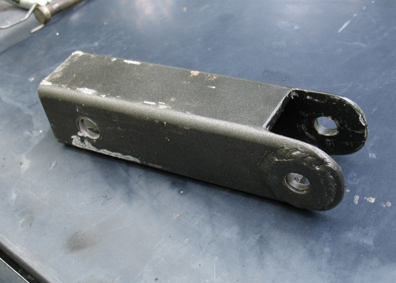

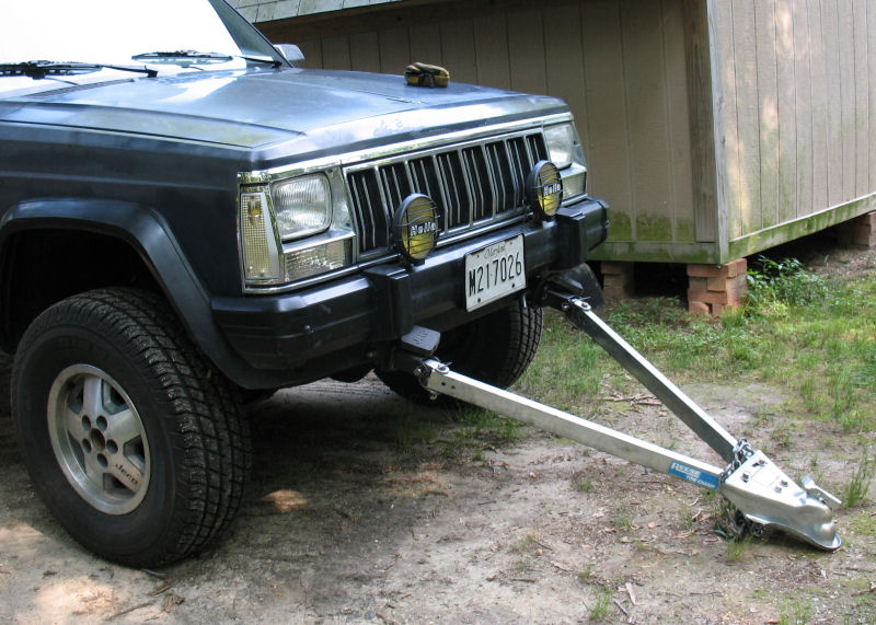

A couple of years ago I put some Class-III receivers on the front of my jeep for use as recovery points and also with the intention of eventually getting a tow bar so that I could flat-tow the jeep if I ever needed to. Today I was helping the 90-yr-old widower next door with his car and noticed a tow bar in the corner of the garage. He said that he and his wife used to flat-tow his Bronco II, and he wasn't doing anymore of that so I could have it as thanks for helping him out.
I got a hair to figure out what was needed to make this work so started some measurements, $40 and a few hours later and the damn thing is installed.
The tricky part was figuring out how the knuckles would have to work. Since I don't know the height of the vehicle(s) that may end up dragging my ass home, and there is no federal standard for hitch height, I needed to be able to go up and down a fair bit. Another factor there is that the bars needed to spread out a bit as well, which meant the knuckles also needed lateral play. The knuckles that were on the hitch already provided lateral movement on their own by the way they were bolted to the arms, but I needed to provide vertical movement when interfacing the knuckle to the receiver inserts.
The easiest way to do that was to notch the end of some square tube so that the knuckles could rotate up and down as needed, while still having a firm connection. With that in mind I bought some square tube and knocked up a couple of pieces. After I got the layout finalized I had the shop cut and drill so everything was square, and also had them weld some washers on the flaps to provide additional strength against bending.
In order to do this however, the knuckles also had to be thinned down a bit so that they would fit inside the square tube "ears". As it was, the knuckle itself was already narrow enough, and I only needed to knock down the tube insert to be flush with the knuckle.
And there ya go.
If I cut the ears back a little further I can probably get the tow bar to lay flat against the bumper, so I could just drive around with the thing installed and use it like a stinger (:rof:).

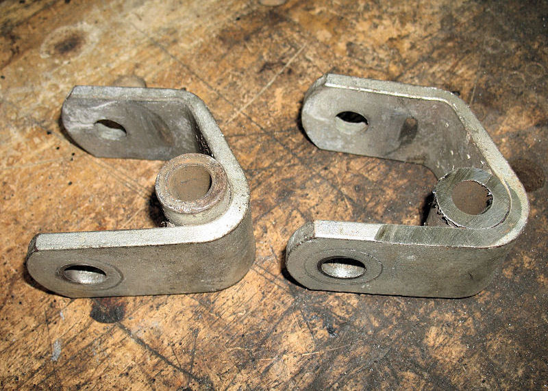

Last week I greased up the caliper bolts and sliders and inspected the axle u-joints. The passenger side u-joint was clearly shot. As you can see below, they are all dry, while the black stain is what's left of a needle bearing that got pulverized somehow. These are the 5-760x that I installed new in Dec 2007, so that is 30 months of use with non-greasable u-joints (sorry for the fuzzy pic).
I really need to have greasable joints if I'm going to be doing snow and mud so I decided to buy the Alloy X-Joints. They are solid center like the 5-760x but have zerk fittings on the caps to grease the local bearings. I think Begster runs these on his trail jeep.
I also decided to clearance for full-circle clips since the Alloys include them in the kit. It looks like the best tool for this is an ~8" bench grinder but I don't have one of those so I had to figure something else. The only thing that worked in the end was running the Dremel through the ears, and clearancing from behind. Slow going to do 4 ears, I probably used half a pack of the reinforced cutoff wheels, but the job got done
Here's a pic of the X-Joints installed. Smooth and quiet on the passenger side now.
I have another joint for the drivers side, and will swap it out in a few days when weather clears up a bit.
Drivers side looked bad but was very smooth. One of the caps was getting rusty but had not died yet.

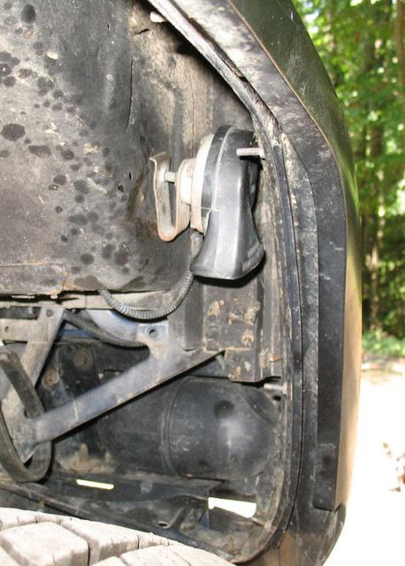

Did some simple work that has been bugging me forever. First up was relocating the horns. They stopped working so I figured do this while I fix whatever problems... one horn had a connector full of mud and was preventing solid electrical, the other horn just don't work and has a rattle inside. For relocation I folded the bracket in half and drilled hole in the side of the inner fender so the horn could be moved up behind the headlight. Seems like a good spot, although it may need to be moved higher when I go to bigger tires and move the axle forward

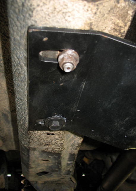

Last thing was to replace the trackbar bracket hardware with new nuts and bolts. I have been having to periodically tighten the original hardware, and some of the threads on the originals were flattened from rubbing on the bracket, so I figured I would replace all of the old stuff with new parts and see if that helped anything. I found some class 10 flange nuts at True Value, and some class 10.9 bolts in my baggie, and larded them up the red loctite. I still have some popping noises that I need to locate, but I'm pretty sure the bracket isn't moving around.
