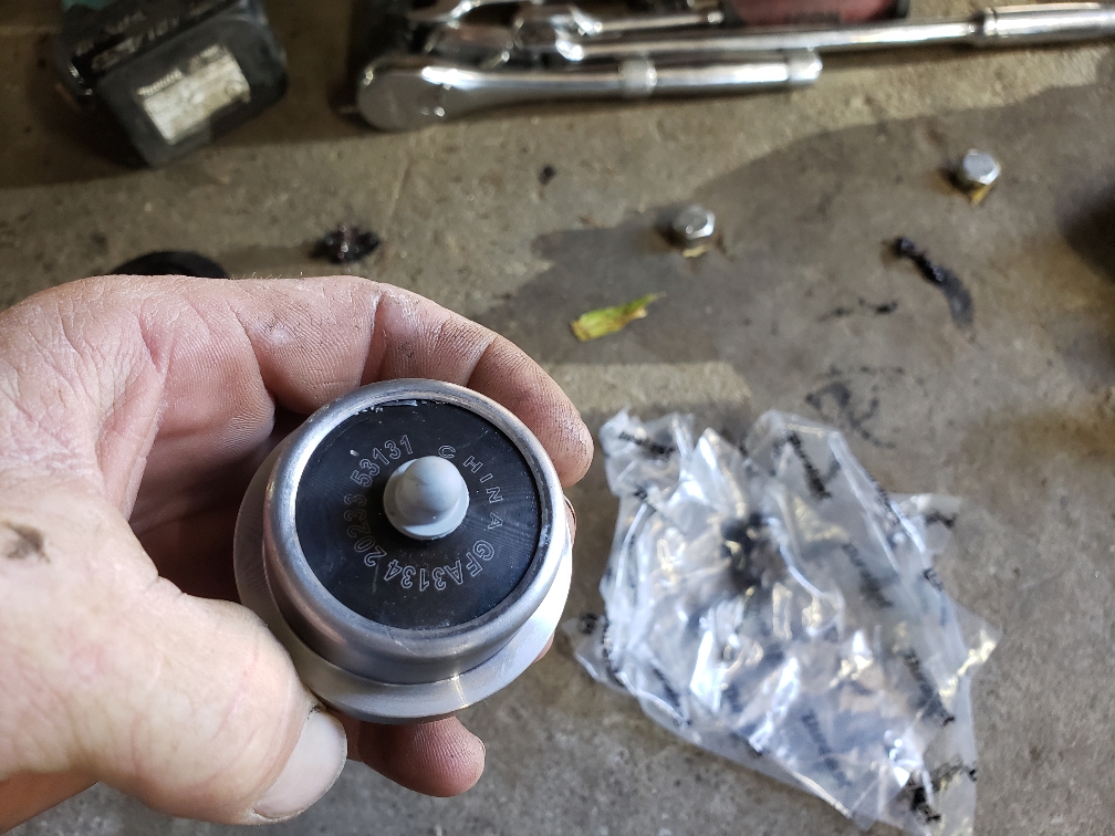

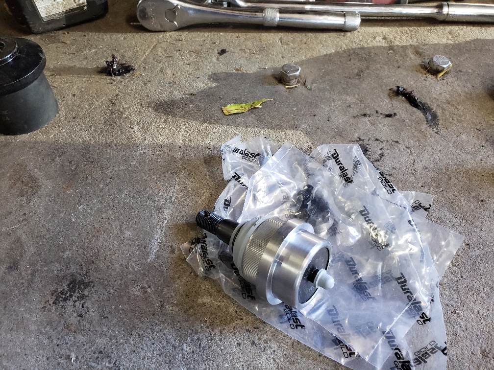

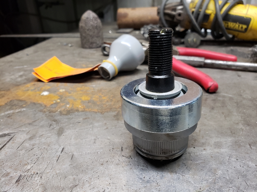

This is a duralast gold upper from autozone. I got less than a year on the economy joints.

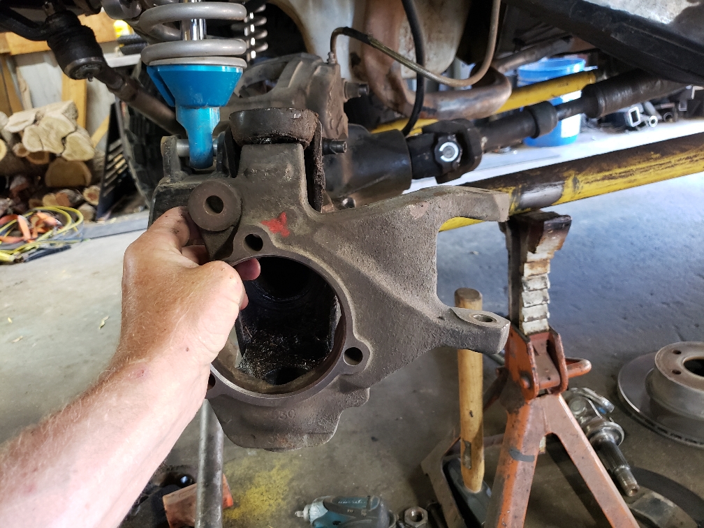

Im assuming upper for a 89 doesn't work with wj knuckles. Im not ready to do the wj swap yet. Need spacers, bearings and might do a set of calipers though not sure wich calipers I have.
Im replacing the economy joints with duralast gold under warranty.
Here's the gold upper suposebly a moog part ? Don't know if that's a good or bad thing.
Yeah its knurled
Yeah its knurled

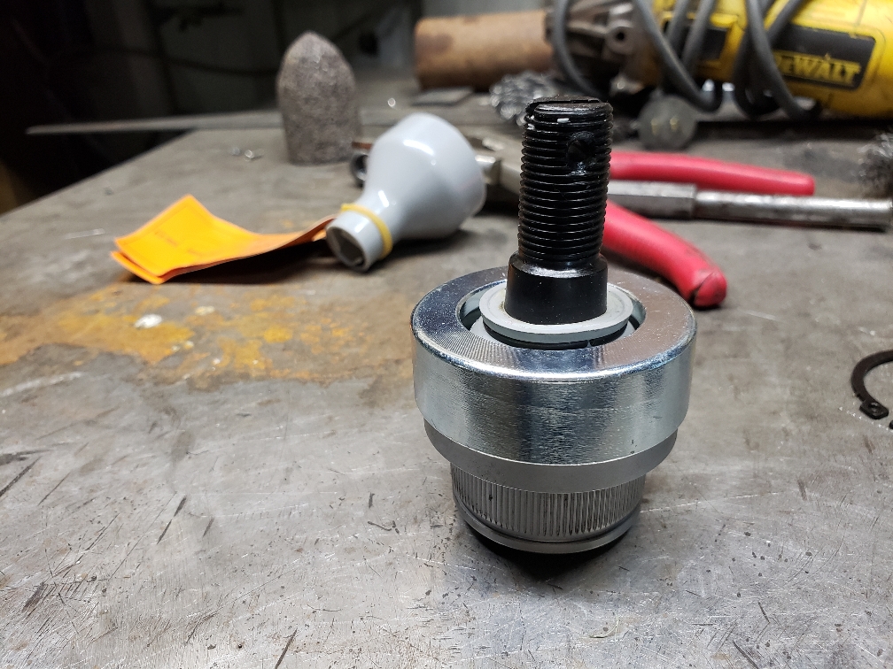

Not as :bling: as yours, but these RC ball joints def feel hefty. Impossible to convey over the internet, but def feel HD. Hope they last a while... so far exceeding expectations

Those look beefy.

On the original WJ knuckles, the Bearing hub pilots into the knuckle. That is what hold it positionally in 2 degrees of freedom. The bolts hold it in the tererairy, or third degree, ie rotational in this instance. Yes, I deal with this stuff at work. With the spacer not welded, it could move. Do what you want.
