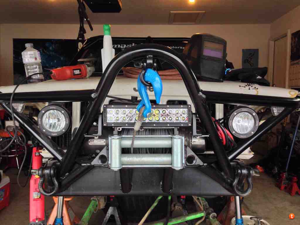

Installed one of my Smash Hole Motorsports Squatch series 12" bars. 5000 lumens combo pattern. Fits perfect between the stinger.
