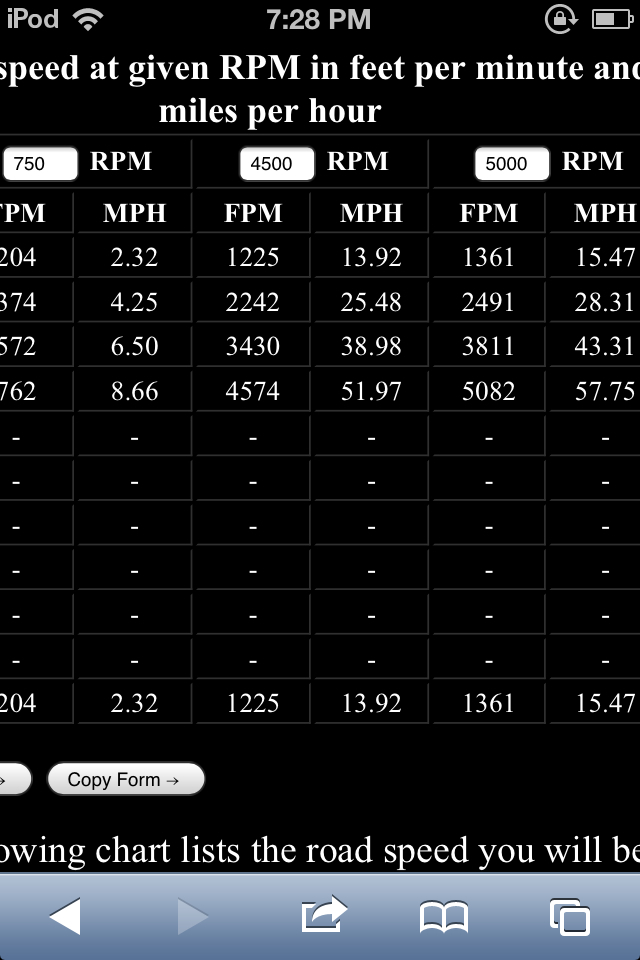

4.56 gears and 33s I cant get up very many mountain roads at any speed over 55. I end up spinning close to 4500 RPM pretty frequently and for an engine with 150k miles and a 5200 RPM cut, thats pretty sketchy to me.
Doesn't sound sketchy at all, sound about right for it, remember this vehicle came with 28" tires and 3.55 gears.. Hell you got it better that your higher speed at 4500rpm than the stock does
This is where it's Rpms and speed is for the factory size
