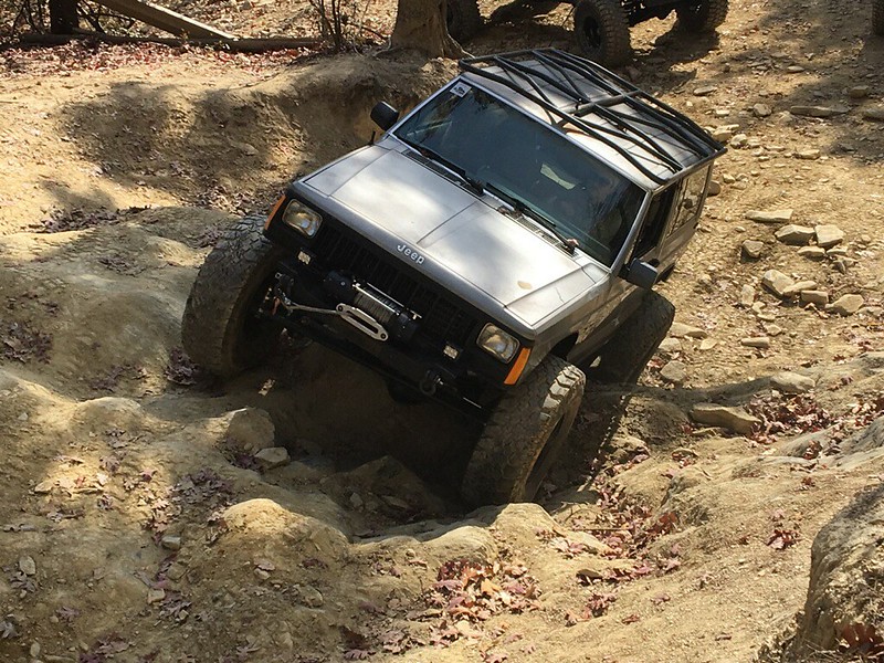

Here's the only pic I have at the moment. As soon as pics/vids start showing up from the ride yesterday, I'll post them

It sure is. Only two made that line on Boulder. Robby Mosley made it up with his Iroks but he beat on it to bounce up it (as he always does). We made winch hill fairly easily but Perimeter hill was a different story. Only two attempted it and both had to winch out of some very sketchy lines.
