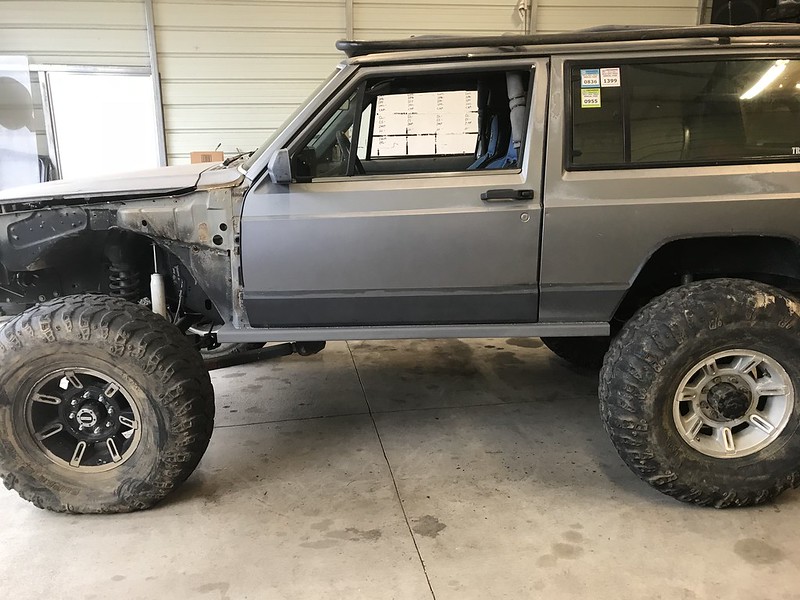

Saturday was a long day in the shop. I was only able to get one of the 2x6 rockers in. I spent most of the day working on 3 linking the front and rear of a TJ. Also, yesterday I picked up a brand new spare tire. Now I just have to decide if I want to put it on an H2 wheel or just get a steel wheel.

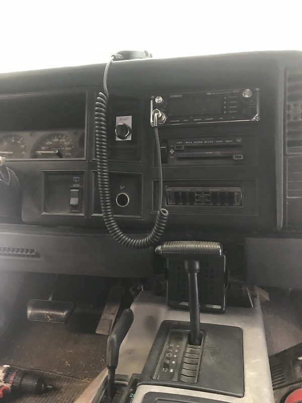

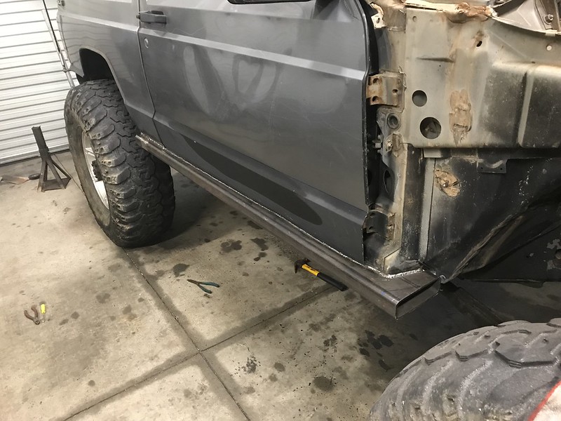

Finished up the cb in the dash, welded in the supports for the passenger side rocker, welded in the drivers side rocker and bent up some A-pillars for the cage.

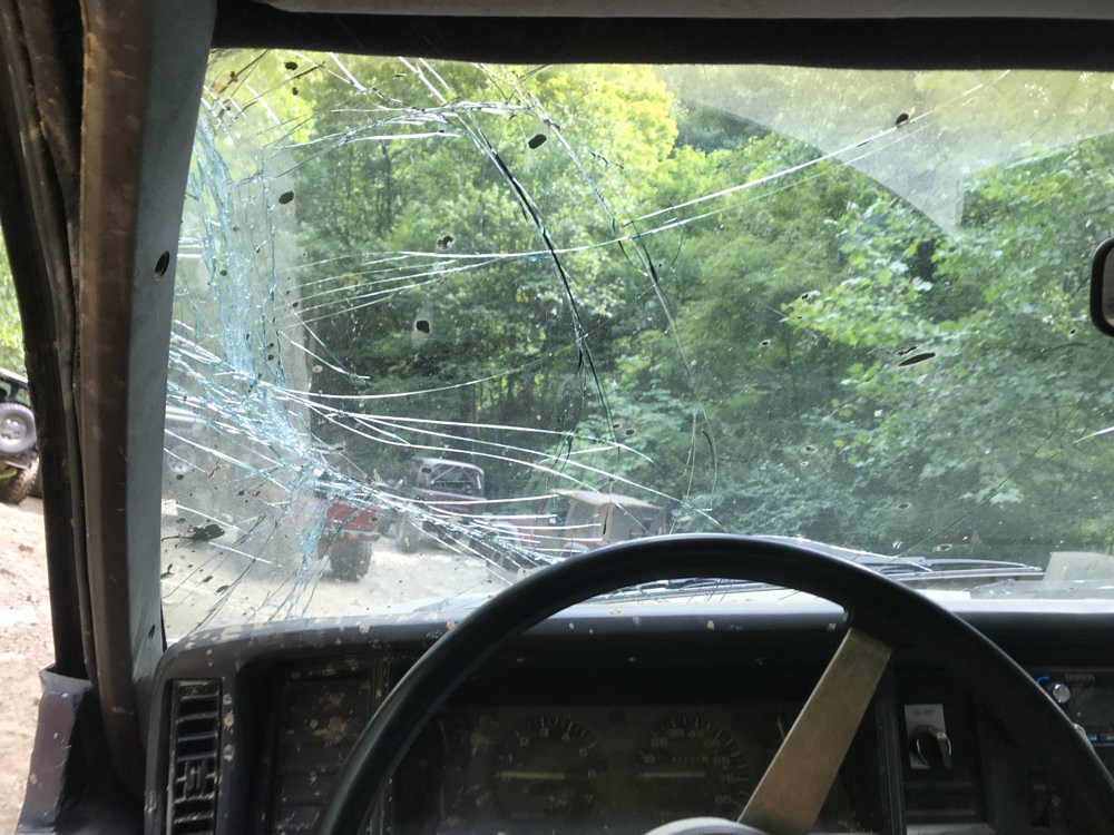

In August we went to Harlan. Destroyed the driver Apillar and windshield on Crawford’s Cry I believe. I’m a dumbass and left the jeep in reverse, instead of drive, and took a giant rock to the Apillar that was going through my window. Also broke the passenger tail light, passenger locking hub, destroyed my half doors, and all 4 of my wheels are now squares.

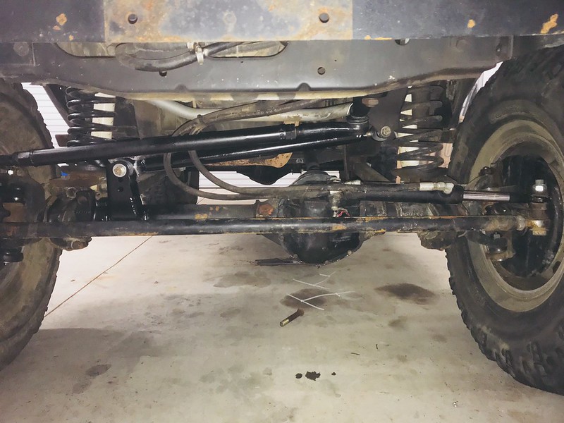

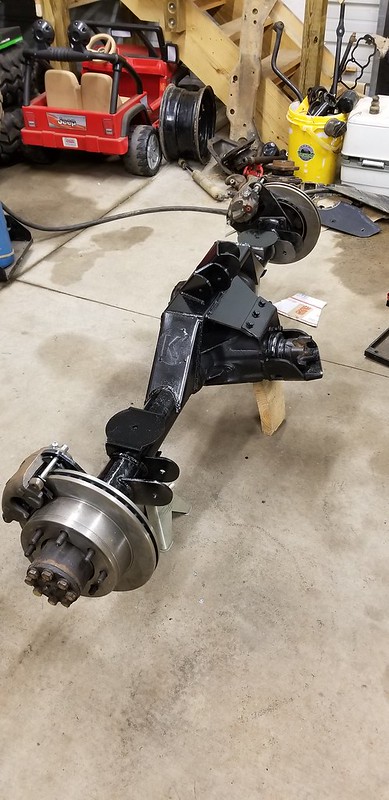

So that brings everyone up to speed. Now I’m getting ready to tear down the front again. Picked up a weld wedge 44 from a member on NC4x4. It’ll be going in with everything from the current axle along with a true 3 link and some Fox coilovers. Hopefully this project will begin in the next two weeks.

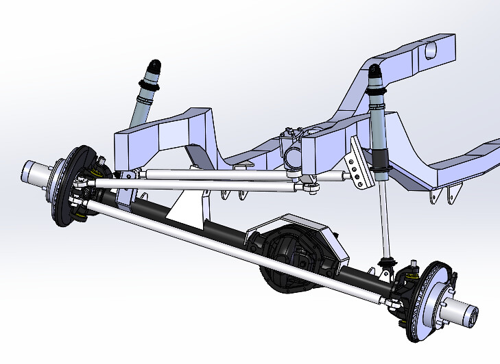

In preparation for rebuilding the front, I picked up some replacement fenders and header panel. I've also purchased Ruff Stuff front frame stiffeners, and frame/axle side track bar brackets. All other brackets, truss, shock towers, etc are from Barnes. Since the shop has been filled with paying jobs the past month and a half, I've been working on modeling up the front 3 link. The plan is for 5.5" up travel and 6.5" down. Initial springs will be 150 over 250 and valving is 50/70.
Ride Height
Full Bump
Full Flex
