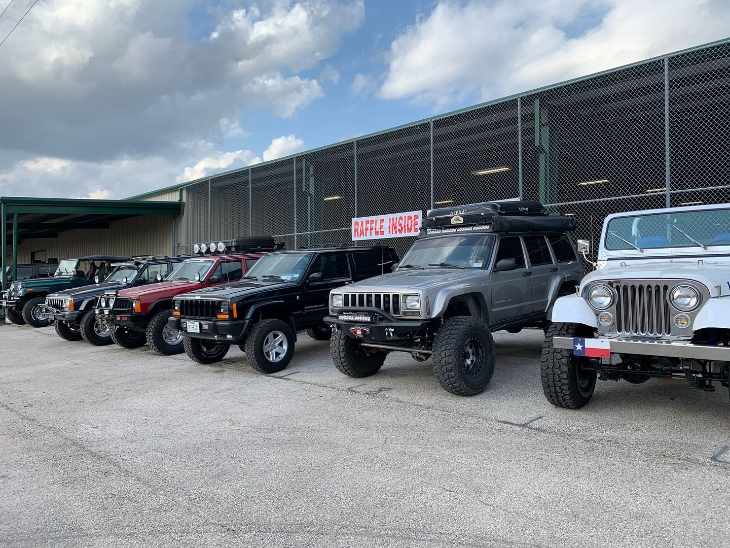

Met up with daughter for part of her spring break @ Lone Star Jeep Invasion.
Of course mostly new JL & JT but also quite a few nice XJ's were there.
Didn't win the stock class we entered and didn't think would win anything. But unbelieveable turn of event, she was called for runner up in Best Of Show :)
Great memories and that alone was the capstone bonding of Dad & Daughter XJ Jeep build.

That's not "East Texas"!
And 3 of those Jeeps are not red.
I understand the black one.
Having my own thing for white ones, I would be happy to provide alternative accomodations for the others. :laugh3:
As for parts hoarding, well, I will be honest enough to admit I am jealous. Well done sir. :cheers:
Nope pic was not in E TX.
That was at @GJEEP the best XJ collector ever.
His entire fleet is super nice & immaculate !!!
Not pictured is his incredible "Silver Bullet" MJ build, find thread on Comanche Club.
