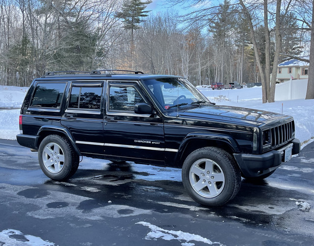

Man, I love it! Such a beautiful XJ. You did a 3.5” lift right? Mind sharing your tire size and wheel backspacing? Sorry, if I glazed over it in your previous posts. I have a 3.5” OME coming for my black 4 door. I can’t decide weather to keep these 17” JK MOABS and get larger tires for them, or drop down to 16” wheels.
Thank you, your Cherokee looks clean !
Tires are BFG 245/75/R16
Got the Quadratec Moab's 8", don't remember BS... But much better than the Icon's.
With ARB rear spring overload removed, the Jeep was still sitting nose down with 3.5" Metal Cloak coils. So replaced them with 4.5" and it's almost perfectly level, 1/4" more on front would be level.
Flexes out real good with 2" bump stop and tru-trac in D44 keeps forward progress.
No trimming & no rubbing even with OEM splash guards.

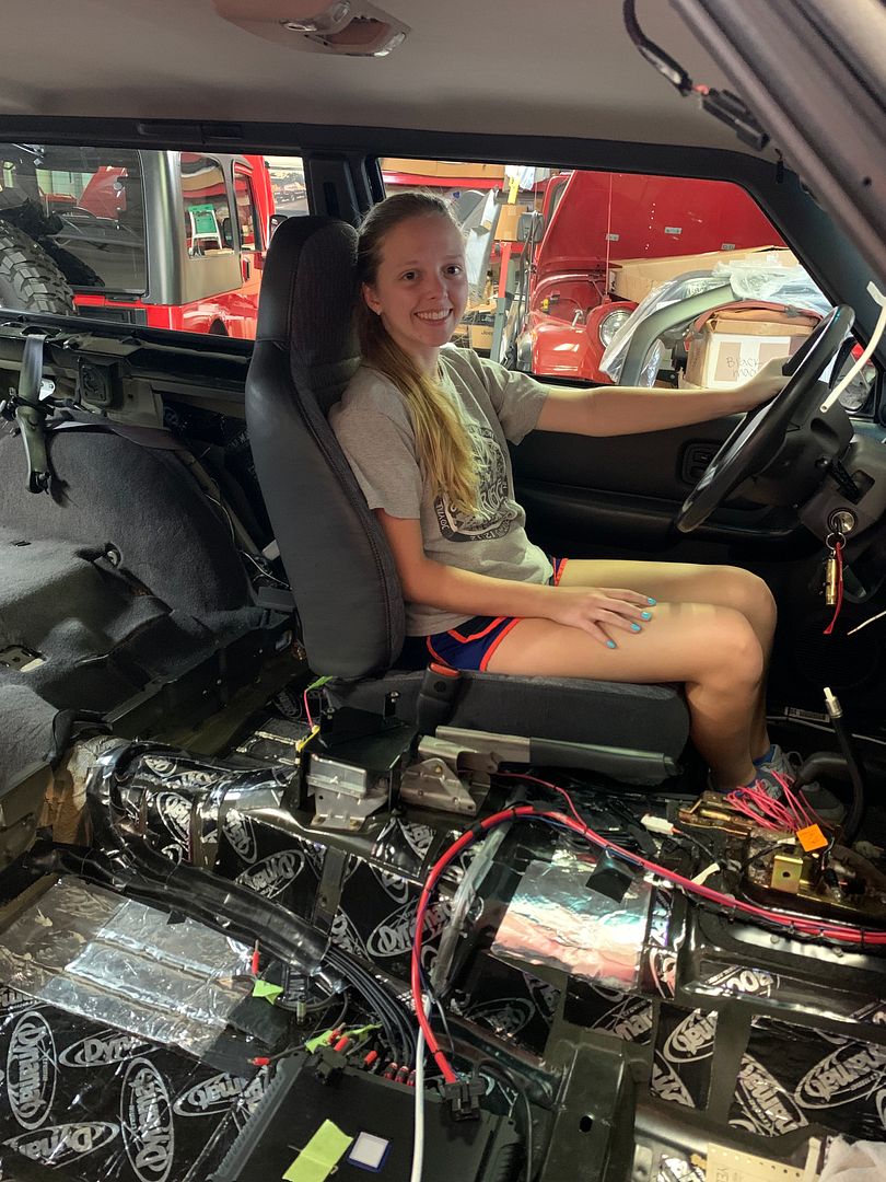

She's applied Dynomat in doors and entire inside of Jeep.
This XJ is so clean that preparing metal for sound deadner was super easy wipe with rubbing alchol.

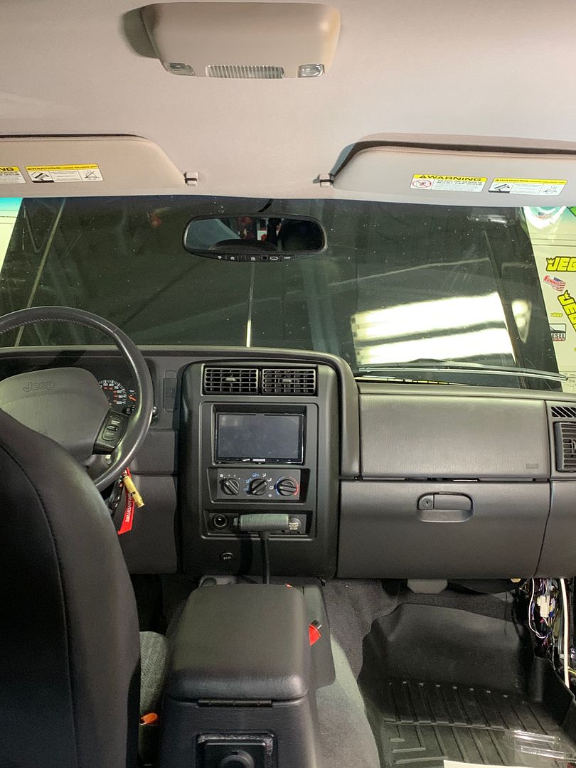

After making spacers for front of Alpine x-A90V amp, it fit perfectly under passenger seat.
Next up is cutting the rear panel for the Subthump speaker box,
Seat heaters, console USB etc...
Well this Jeep build is finally finished :)
I may do LED interior courtesy light upgrade for a Christmas present.
Really like the fitment of the double din, but mostly the functionality.
Having all the accessory switches controlled by receiver is awesome.
