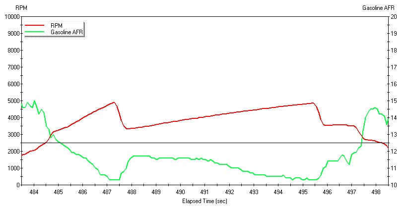

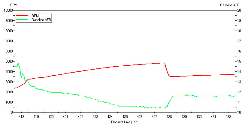

I did two runs today to log the AFR. They were both WOT runs and damn it does pull.. even with a lacking AFR.
Definitely needs some work. The richest it gets is 10.3:1 @ 4800 RPM. If I was running boost that would just be about perfect.
I'm planning to get it to 12.5-13:1.

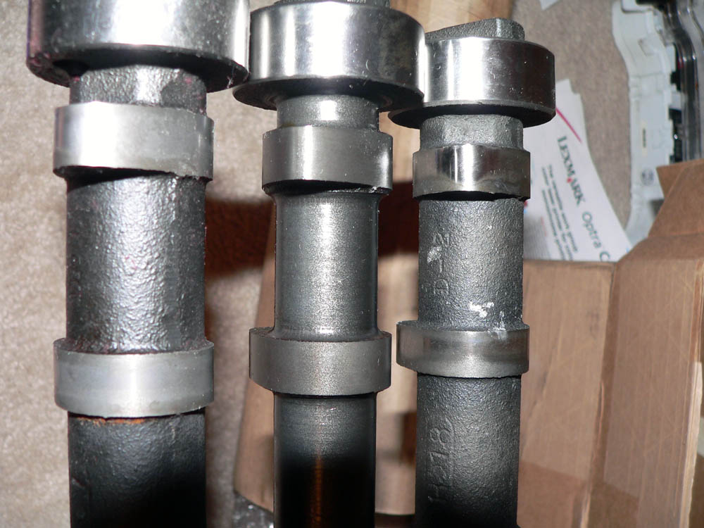

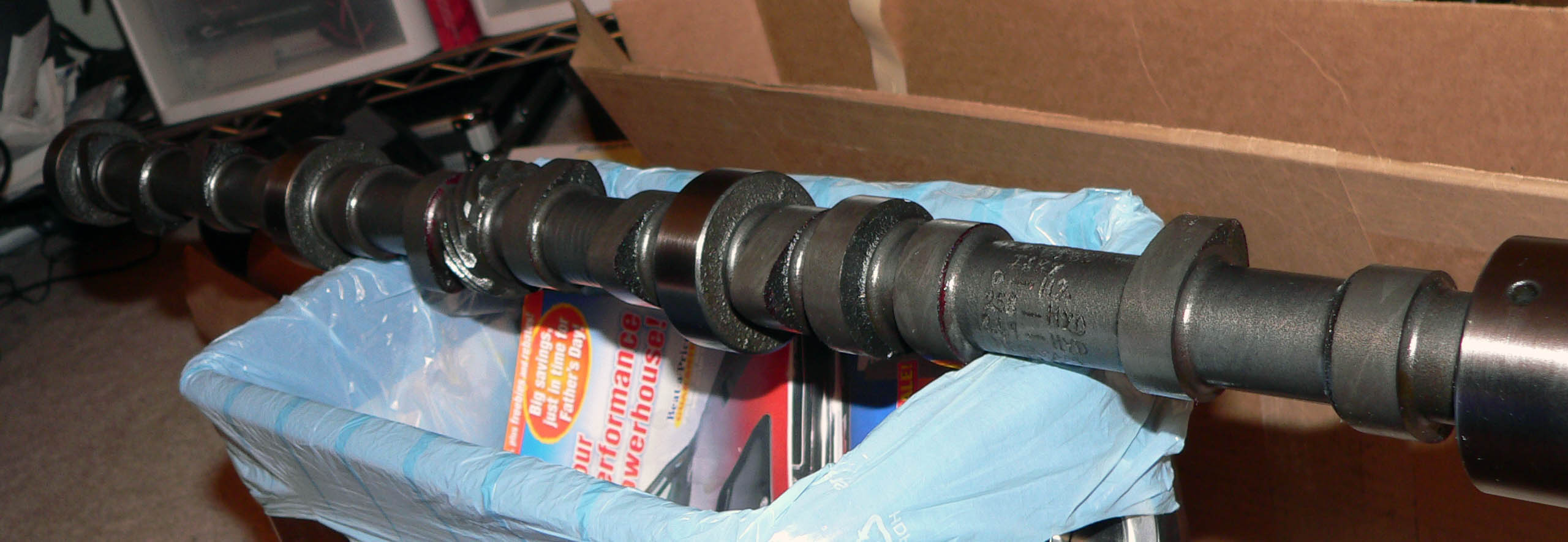

Bit of an update. First I had a thrust bearing go bad. So I looked into that and the crank surface for the thrust bearing was rough. I attempted to fix that with 400 to 600 to 1000 grit sand paper. Then I buttoned it up. Immediately after that I had a hesitation/ stalling issue and an extremely loud valve train. That turned out to be a damaged cam with the noses beginning to be worn off on the cam. So I need new cam and lifters. I talked to Isky and I am having a custom cam ground that will provide a bit less torque then the comp cam 68-231-4, more high end, and a quieter valve train. That should be arriving soon. I also sent the crank out to be fixed by the company that sold it to the machine shop. They polished it up and it should be returned soon. I purchased some Lunati Microtrol lifters that are suppose to provide better oil control, and require less preload. There was a bit of concern that they were really only .903" when stock is .904". However they measured .9036-.9038" as do all the other various lifters I have measure. So I am going to run those. The Comp Cam and lifters were sent back to Comp for diagnosis and refund and they could not explain what happened. I think perhaps the cam wasn't hardened correctly. I personally talked to the RMA diagnosis guy and had no insite into what happened. The break in was correct, the spring pressure was good and the oil was good. So I don't know otehr than teh hardening theory. I went with the Isky for the replacement cam because they a) they listened and talked to me (a few other companies didn't) b) they did dual pattern c) they recommended a decent custom grind and d) their ramp rates weren't as fast as the Comp cam.. while Lunati's were faster.. I didn't want a noisy valve train again.

Received the Isky cam yesterday... sooner than I expected.
The surprise was that for some reason they cleaner up the shaft between the lobes quite a bit. An unmodified shaft measures 1.265" in the bare cast sections. Where Isky machined it measures 1.08". Wonder what their reasoning is... looks? weight reduction?
